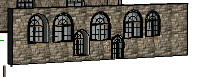

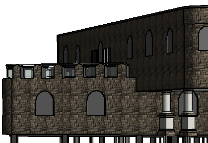

Hello, im a student and am having an issue with windows in my final project, ther is a grey thin cover over my windows, it's happening with only this type window. sometimes on the inside sometimes outside. changing detail level sometime solves problem but, only for a short time (30 seconds), sometimes switches greyness from inside to out. had these windows in project for weeks with no issues then three or four days ago this greying started and is there everytime i open

I might be that the window opening does not fully cut the wall.  Is this a really thick wall?

The wall is 1' 5 3/4"

tried on an 8" same issue

Don't know if this applies, but it may be Video Card related. Just status (Option=>Graphics). Sometimes I get what I describe as "ghosting" on my windows. Sometimes a re-launch fixes it, sometimes updating (down-dating) driver fixes it. Good Luck.
