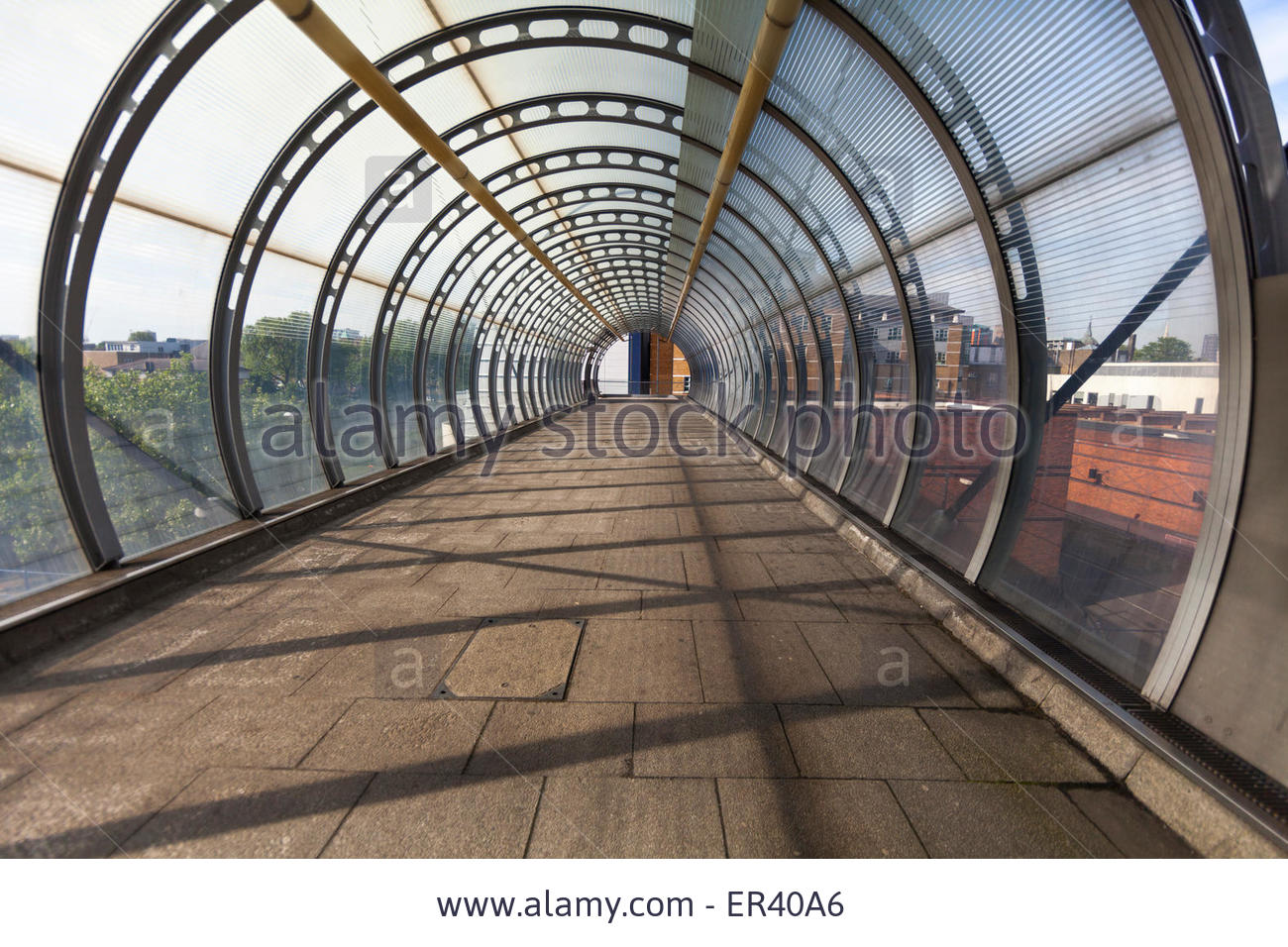

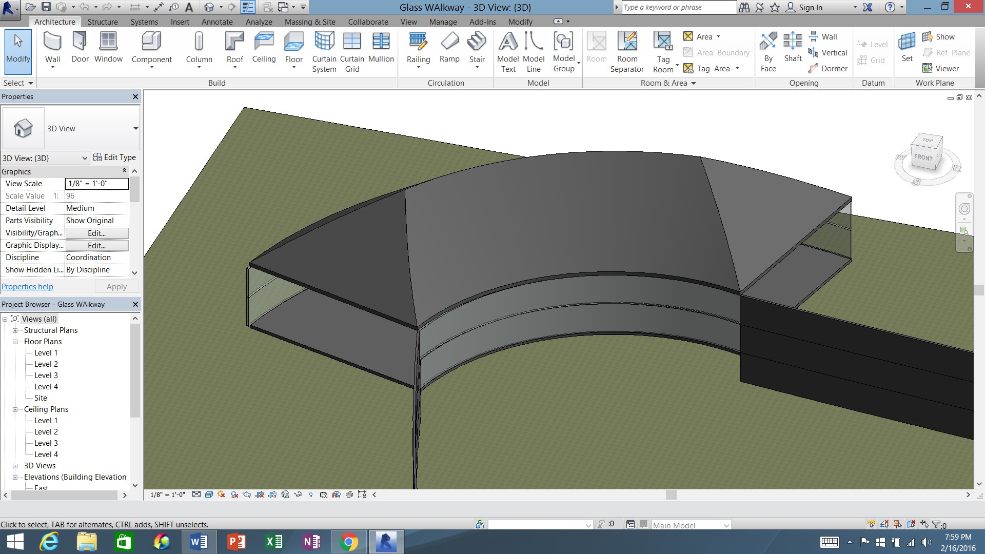

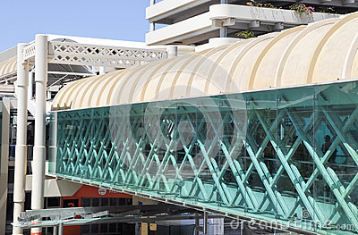

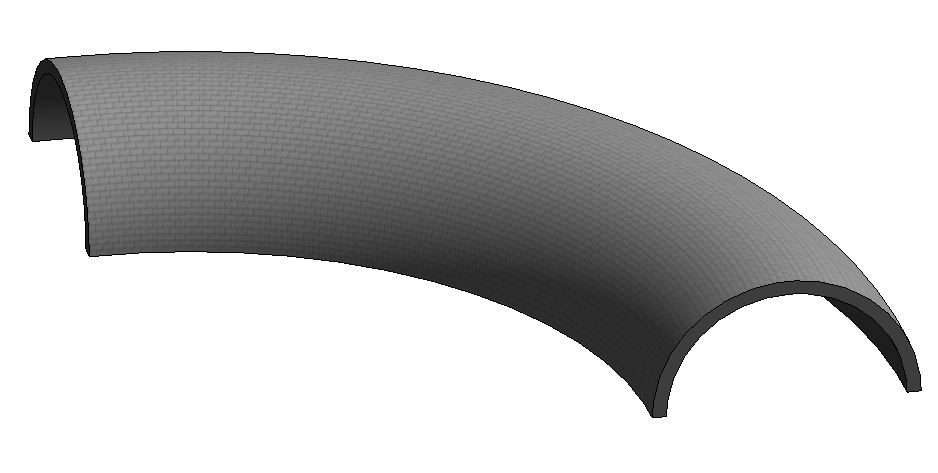

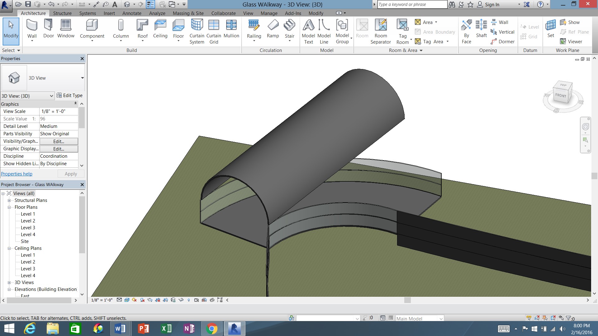

I am on a team that is challenged with designing a school. We want to build a curved skywalk going from one building to another. We also want to add a curved roof/ceiling. I have tried to create a roof using the "roof by extrusion" tool but when I create the curvature of the roof and hit the check mark, the roof is a rectangle. I need to be able to match the footprint of the roof to the walls of the building.
Picture 1&2: What we want to base our design off of
Picture 3: The roof by extrusion only being rectuangular
Picture 4: This is where we want the roof to lay but it isn't curved like we want it to be

Wow, that IS a significant challenge! Great clarification. I get it now. I'm going to need to gnaw on this one awhile, but I betcha somebody now will beat me to the punch in the mean time. Right off the bat though, I'm thinking Roof by Mass Face.
Edit:...or a Sloped Curtain Wall????? mmm?

This is an interesting challenge. Love to get other's input. I can get there by sketching an in-place mass and the applying a roof by face. Don't know if it's the ideal approach, but for a quick one-two, it seems acceptible.
Wed, Feb 17, 2016 at 7:49:37 AM | Editing the footprint of a roof by extrusion?
If you want all the layers, then Roof by face is the best.   You could do an in-place model in the roof category like I did.

I think the best overall approach would be the Roof by [Mass] Face.
