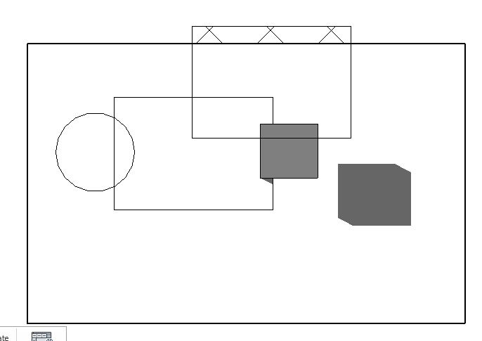

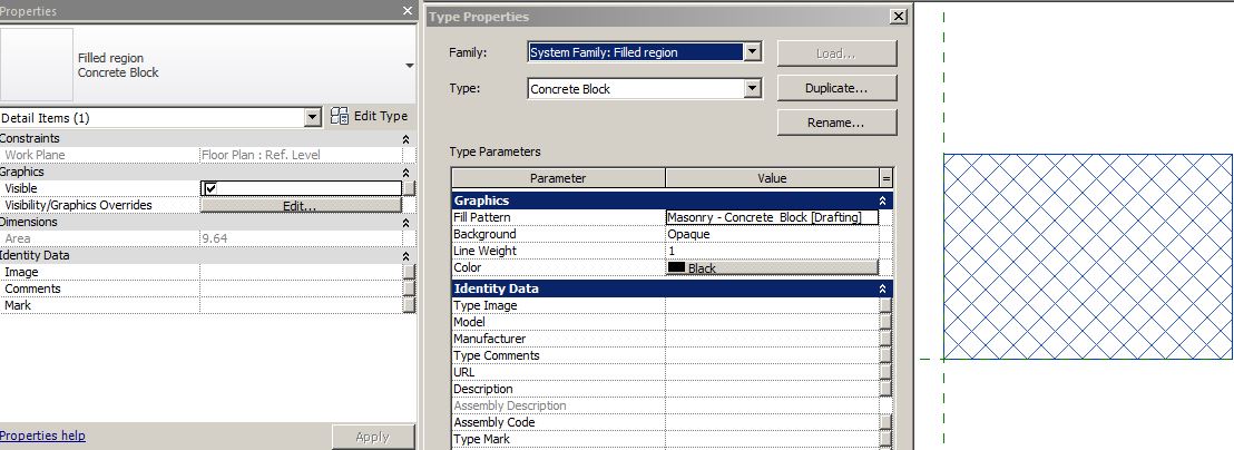

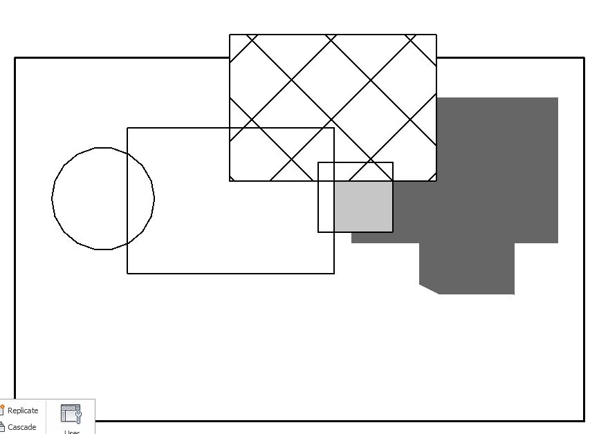

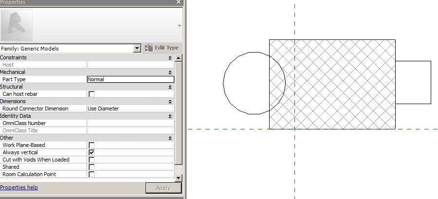

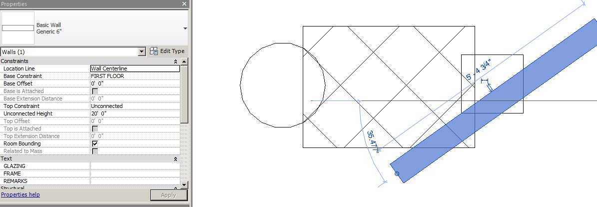

If you notice, in my first post I only suggested that you change the default material setting and I asked you to report if it worked.  I did not know if it would or not.  So I followed your test.  Images:
  1. Detail with opaque filled region
  2. Detail loaded into Generic model with annotative line and 3D cube (Note region hides cube only.)
  3. Generic placed in model with wall.  (Note, region is white and no longer hides cube or wall.)
  4. View set to consistent color or shaded.  Both Cube and region are grey.
  5. Default set changed to white - Generic set to model material.  (Note - cube is now white so default only affects the solid)
So the grey problem is only in a colored view not hidden line.
