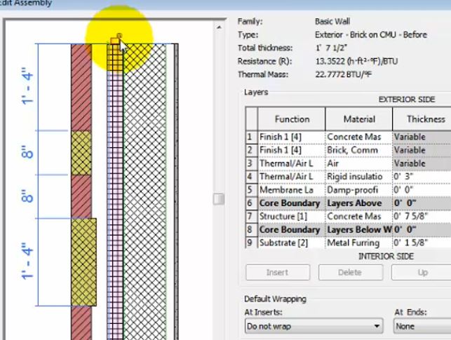

Is it possible to take a profile of a sill plate and "nest" or insert it into a profile of a cap block so I may generate a model of the sill plate on top of a cap block? I wish to do this so I may change the dimensions/parameters of the cap block and sill plate independently for custom needs.

I think teafoe answered you correctly in your other post.  The cap block should be part of the wall.   The sill plate cout be a sweep element but the cross section view of these items is far better off being just a detail element rather than an embedded detail item.
In this case, your foundation wall should be your block width with a thinner section at the top where the cap block is.  You can describe all of that in your wall type.

Watch the video here to learn how to modify your wall.
