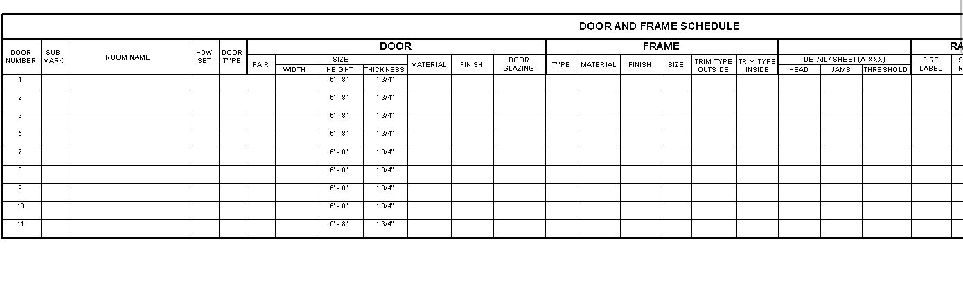

My firm has an established door schedule standard that we use, which works well for us. I'm of the opinion that anything could be improved upon, but as I'm going through and setting up a revit graphic standard template which matches our autocad standard, I'm finding that its difficult to recreate the way we typically convey information, particularly schedules. I've attached an image that is our standard door schedule with generic info. Is this type of schedule feasible in revit? I wouldn't mind including extra information (such as cost, room number etc) that revit can easily provide, but is it possible to have our two tiered header bar with references to particular details per door, etc?Thanks, C.

That schedule is easy to do in Revit.  A partial view of our Revit schedule is attached.
