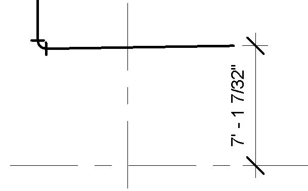

Dimensioning sloped pipe seems to be a major PIA.. when things aren't "PERFECT"..
What I mean by that is I can dimension pipes to themselves, BUT not to the grid as due to the slope of the pipe, my pipe got off a .01 degree I can't go realign everything it would mess it all up. So I am forced to draw detail lines on teh center of the pipe, and then THOSE I can dimension to the grids.
Another issue is pipe upor fittings, I can highlight the family and see the snaps to dimension too.. but again I can't dimension. So I have to go draw a small tick mark from teh center of the fitting to be able to get the align dimension command to dimension.. I know its because everything isn't 100% square. But by that I mean 99.99% square. Enough even in a multi-story office building the amount of is line a 1/4" over a 100 feet.
Is there a tolerance option I am missing ?
FWIW, Revit 2015 had the problem since 2010.
Edited on: Tue, Feb 9, 2016 at 9:54:31 AM
Tue, Feb 9, 2016 at 10:04:47 AM | Dimensioning tolerances to use align dimension with grid lines ?
If you use your tab key, you can dimension to endpoints - see attached.

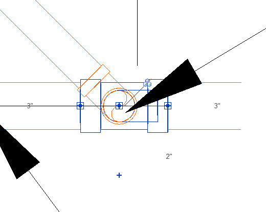

Yes Tab doesnt work in these cases, neither does typing hot keys..
Overall its just annoying. See SOME fittings it may work on .. others it wont ( same family ). I have boiled it down to fittings being off a little ( they were nudged a bit during coordination or something like that ). Again its a MINOR amount.. and the dimension never changes..
If there were a way to tel revit, hey dimension this stuff anyway, or let me tag that center even if I am off the plane by .1 degree.. that would solve it. Instead everythign has to be 100% square to the grid lines. I underestand the why, but we are contractors, so we don't need fittings 100% and we dont need systems 100-% connected.. we need them clear for coordination and sometimes that requires nudging a piece here or there.
Thats issue #1

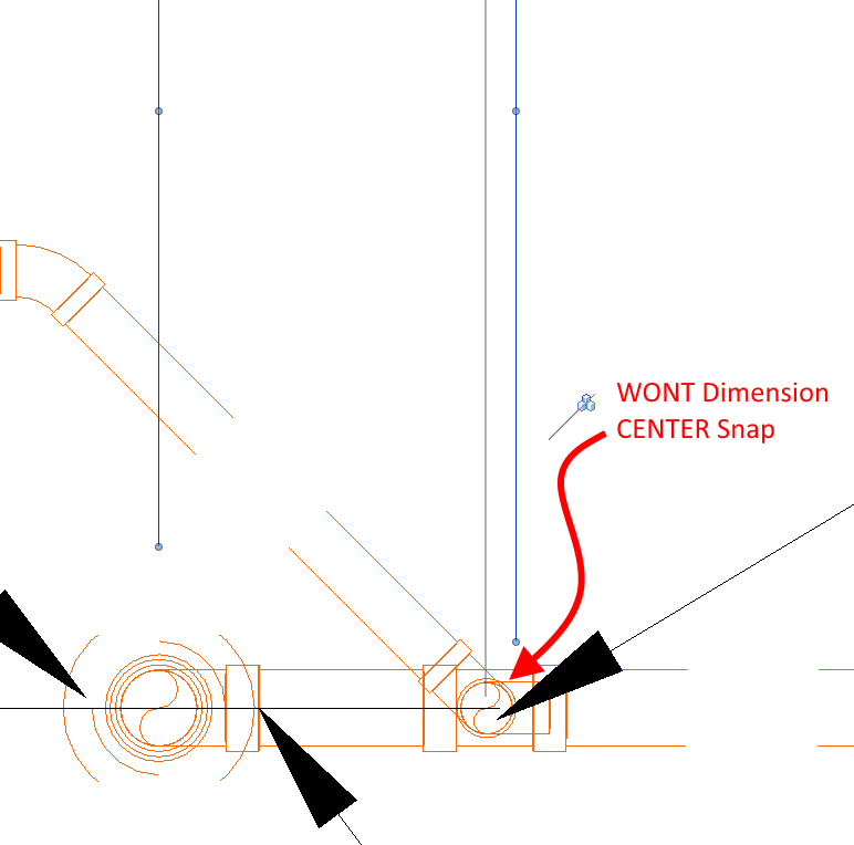

Issue #2, is when it won't let me snap to centers of fittings. Its especailly a problem when I have elbows going down.. or pipe that is cut at the view limits.
See attached..
Capture shows that I am trying to hover over and tab to get the center of the pipe.. but no dice.
Capture1 show that IF I highlight the family the snap is there..
In both cases, the solution is draw a line and then dimension to that. Becuase I CAN draw a line to the snap.. I just can't dimension to it.
Tue, Feb 9, 2016 at 10:51:01 AM | Dimensioning tolerances to use align dimension with grid lines ?
Sorry - I can't recreate your problem.   I don't have that problem - even when an item is slightly off axis.
