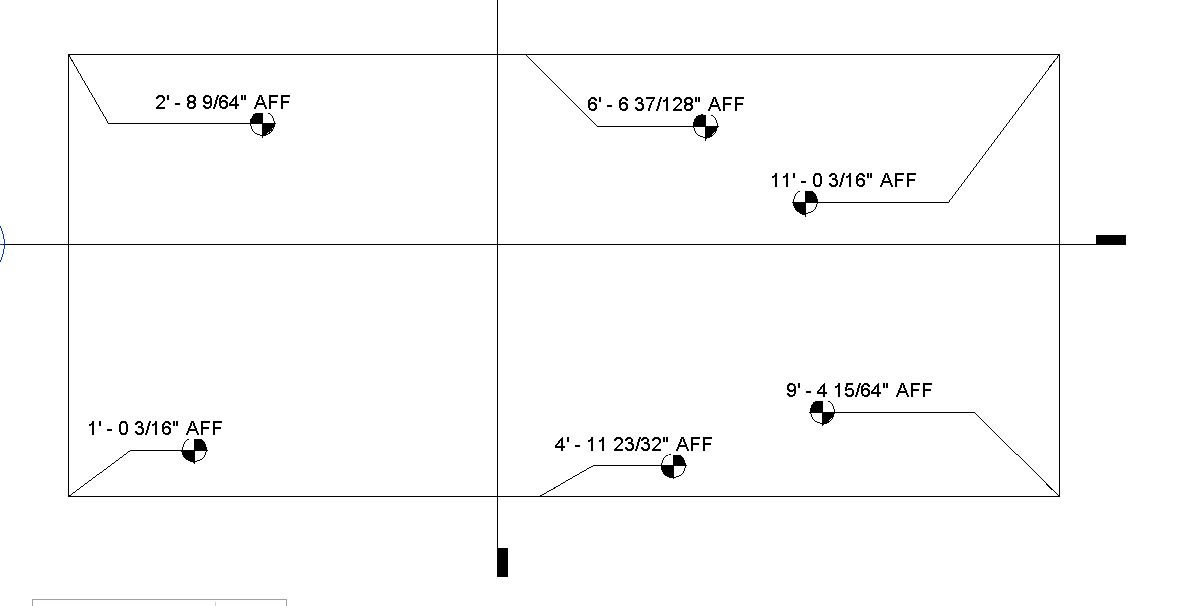

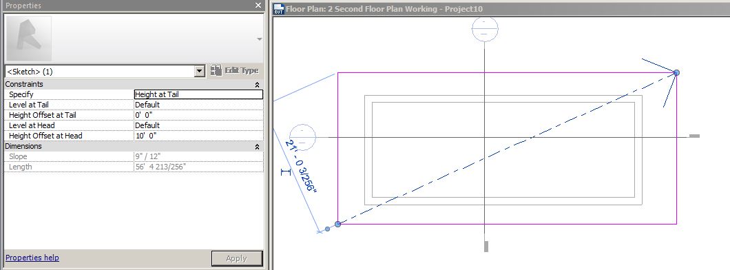

The roof arrow slope can be place in any direction edge to edge.  See attached.

Wwhub is that sloping in both directions thats what i need and when i place two slope arrows i get an error.
Thu, Feb 4, 2016 at 12:22:25 PM | Roof Help!!!
Yes, look at the attached image where I added spot elevations to the roof.
Note - getting this to work correctly is not easy.   You have to find where that line should be and what the elevations should be.

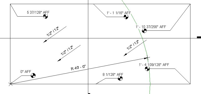

Thu, Feb 4, 2016 at 12:39:58 PM | Roof Help!!!
I decided to add a couple of images to show how to control this roof.  In this case, I want a roof that slopes 1/2" / 12".
In the left image you will see that I changed where the slope arrow went to, the circle line, and I changed the height at the head to be 16" to give me 1/2" / 1' over the 40' I laid out with a circle.
In the right image, you see the spot elevations and the roof slope done with the roof slope tool.

Ya i got all my heights that i need but how did you make it slope in two directions with one slope arrow? did you take the arrow across from one corner to the other?
