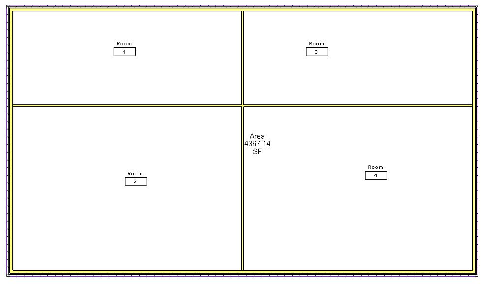

I do not understand your area rant.  Attached is a floor plan with area and room tags.  Linked models do have limitations as far as rooms and areas go.   But the information is still there.   Please review this help.
