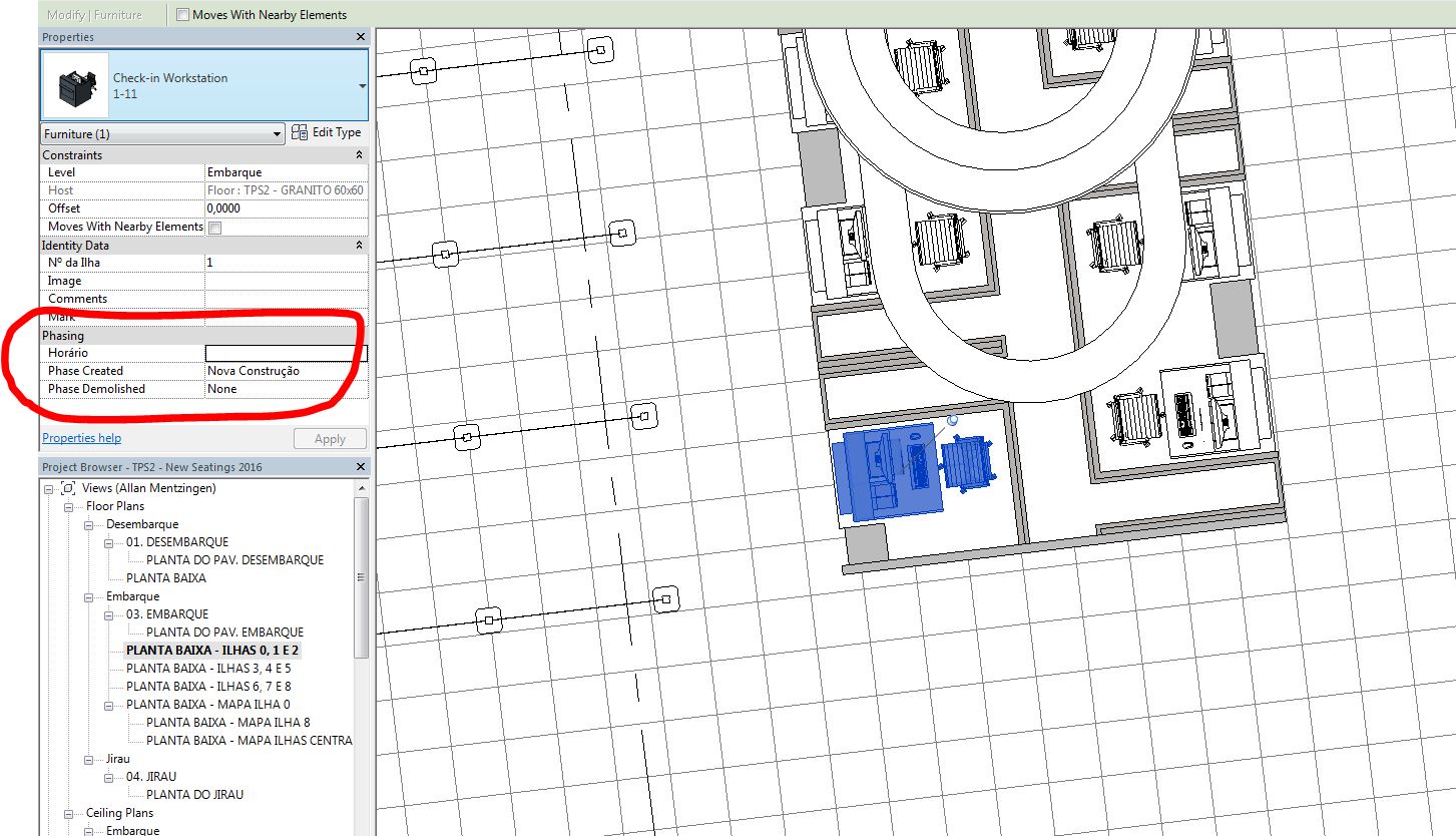

I'm allocating airlines of an airport in each counter (workstation), but some airlines use the same counter in different times of the day. I have created different parameters with airlines, operation times (7 am - 10 am; for example) etc. and made one type to each check-in counter (furniture).
I would like to know if it would be smart to create different phases to represent each airline using the check-in counters in different time period. And if is possible to attribute a parameter value to a specific phase. So, when I change the phase, I will have a different value in the same parameter...
Please find the attached image file below.

Phases are project and can not be identified in family parameters.  You may be better off to use design options for this.
