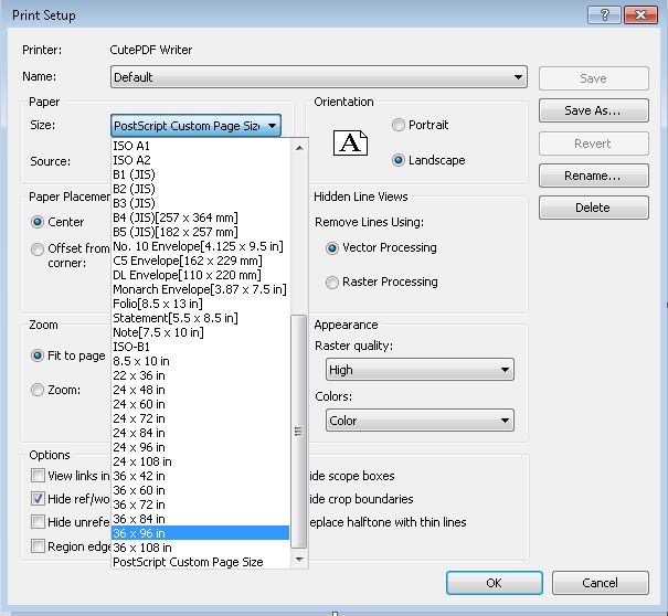

Hello, i have sheet with big dimentions - 1m X 3m
when i want to print it to PDF i found the biggest option as A0
is there a way to define the size of printing?
Thanks, Hagay.
Thu, Jan 28, 2016 at 9:45:10 AM | printing sheets with big dimentions
Printing is limited by the printer and its drivers so we can't answer what you can do.  It's your printer.
Thu, Jan 28, 2016 at 9:52:55 AM | printing sheets with big dimentions
My cute allows for 36"x 108" - about what you need.
Thu, Jan 28, 2016 at 10:17:26 AM | printing sheets with big dimentions
hemmanu
Joined: Tue, May 26, 2015
0 Posts
thanks, i will check if i have this size,
basicly i print to PDF and to to a printer.
i thought that as well as there is a way to defind my sheet size there will be the same freedom to set the printing.
Hagay.
