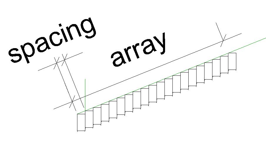

Hello there,
I am not good English grammar but I prefer to show you video I created what I have problem with two row of brick corbel on gable roof, just follow roof angle.
I know about "Architecture tab / Wall / Wall Sweep" but it is only horizontal or vertical instead angle like follow the roof.
I hope you have time to watch this video link below, Watch length is 1 minutes. I can't paste video here because here is limited 2MB :-/
https://www.youtube.com/watch?v=u4m7dngLvEs&feature=youtu.be
I hope you have other method better than mine.
I am awaiting to hear from you.
Bogumil :-)
Mon, Jan 25, 2016 at 7:53:18 AM | Two row of brick corbel on the Gable roof, just follow roof angle.
Because the spaing changes with the roof angle, the easiest way would be to do an array of single vertical components.

Thank you for your respond WWHub. I am not sure how to do with arrary of single vertical componets?
Can you show me video or step by step picture??? I will appriecate that.
Mon, Jan 25, 2016 at 3:14:40 PM | Two row of brick corbel on the Gable roof, just follow roof angle.
Here is an array of a detail element... I goofed because I don't have a mortar jt between bricks but you can see how it works.  Do the same but with a face based brick that stands slightly proud of your wall.

I found it, thank you for some tips :-)
