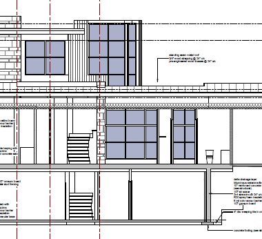

Hi there,
I am wondering how to represent glass as a colour in hidden line view. Please reference attached photos for example

In the material you need to change the surface pattern to a solid fill and change the color to whatever you want it to be.
