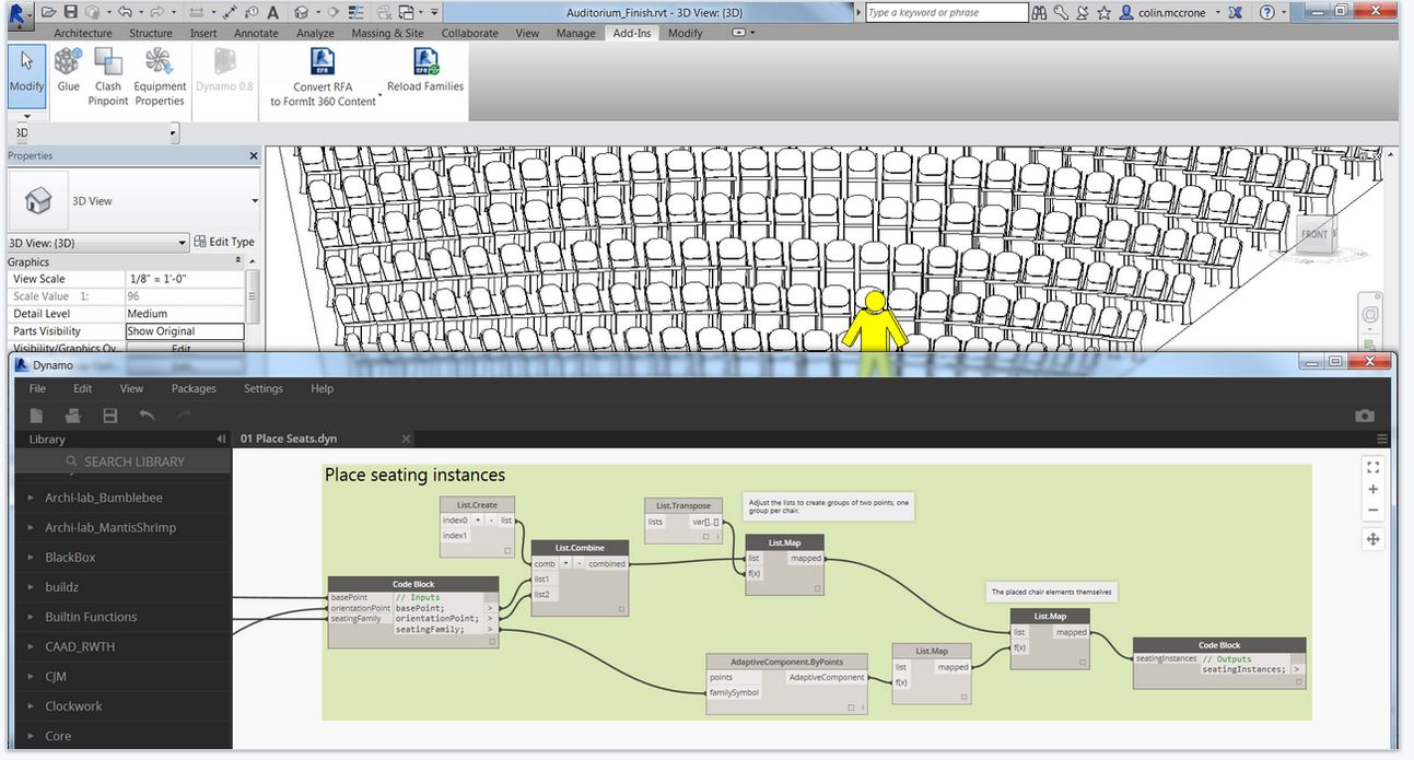

I am working on a school auditorium. I have to document the existing seating.
This is a time consuming task.  I used the original drawings as a guide.
I layed out the radius center point and located the seat rows with offsets.
It is a pain to start at the level, rotate from the center point, array.
I have to do the same procedure for every different chair size.
Now I have to adjust the seating per actual layout.
Does revit have a quicker way to lay these out with various chair widths and have it flex if parameters change?
Mon, Jan 18, 2016 at 3:05:12 PM | Documenting Existing Auditorium seating along a curve
Here is an example of how to let Dynamo do that in Revit:  https://www.dropbox.com/sh/nkj7ghf609inbj4/AABxjtKF5PzRPhIdqaaKXZHBa/04%20Auditorium%20seating?dl=0
