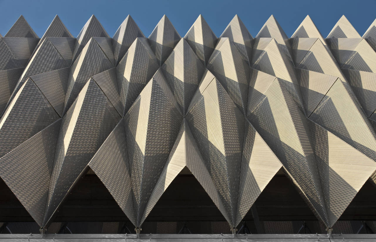

Does anyone knows if i can find a wall (or membrane / curtain wall) that look more or less like that one on the attached photo?

The procedure to create such a wall is too complex to explain here. Explore working in mass environment, divided surfaces and creating custom curtain wall panels. These tutorials will give you some ideas.
https://www.youtube.com/watch?v=PwkqLCIzDy0
https://www.youtube.com/watch?v=iHqVMaNq-1A
Thu, Jan 7, 2016 at 7:46:37 AM | looking for a special wall family
This looks like a good candidate for adaptive components.
