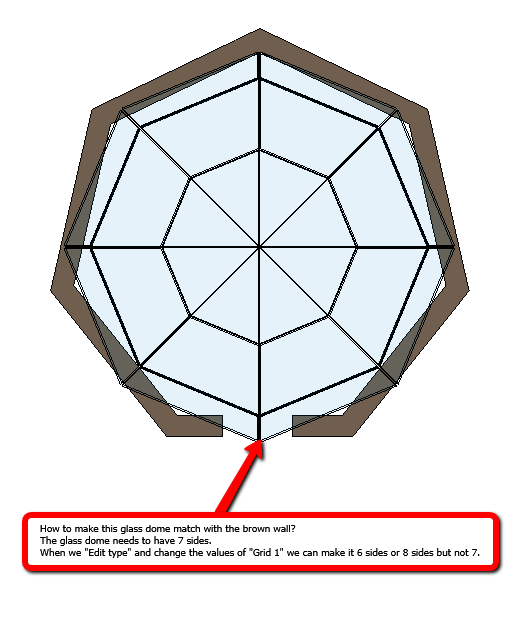

See attach.
How to make this dome match with the 7 sided wall?
By going into "Edit type" and play with dimentions I can get it to 6sides and also 8sides but not 7.
Any idea on how to acomplish that?

Its a Generic "In place mass" using a Revolve and a profile. After that I applied a "courtain system" and I am trying to accomplish the 7 sided dome with changing the spacing on the "Grid 1" under "Curtain system"/Edit Type.
Can you suggest another way or a work around?

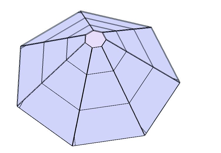

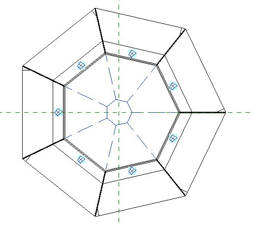

Not sure how you do it with a revolve but you can with two 7 sided shapes.
