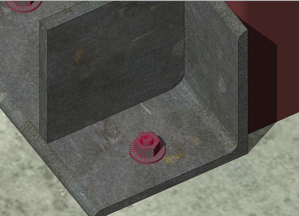

Hello,
I'm trying to render a structural connection in Revit 2016. I'm using Hilti's plug to their modeled fasteners. However, when I render the model, the bolts still show the construction lines. Any tips?
Mon, Jan 4, 2016 at 10:42:15 AM | Hilti kwik bolt not rendering properly
You have to look at their settings....  Look under the family category for that element.

Can you walk me through what I'm looking at/for?
Mon, Jan 4, 2016 at 12:42:32 PM | Hilti kwik bolt not rendering properly
I could if I had the family ... but I don't.  It looks like they may be under specialty equipment.

This doesn't look like a native revit rfa element. It's a family that has an old DWG block inserted and then saved as an rfa file but it's not actually revit solids. This is comman and a simple way for people to use the old 3D CAD blocks in REVIT. ie: Not going to render.
