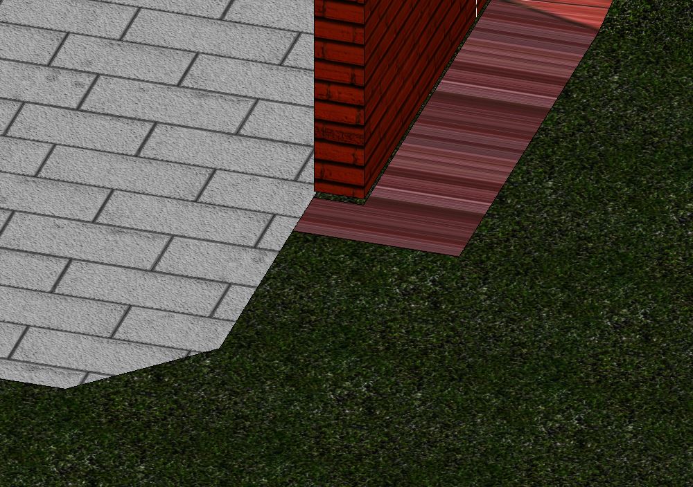

In revit 2016, why is this happening?
The picture shows a subregion made from a topography object.
Thank you
/Totte

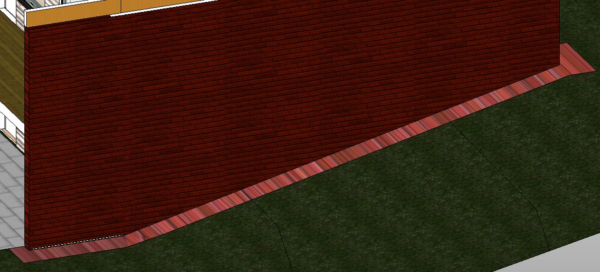

Sorry.. Why is the material in the topography subregion stretched out as shown in the attached pictures? It's supposed to be stoned but instead it looks just awful.

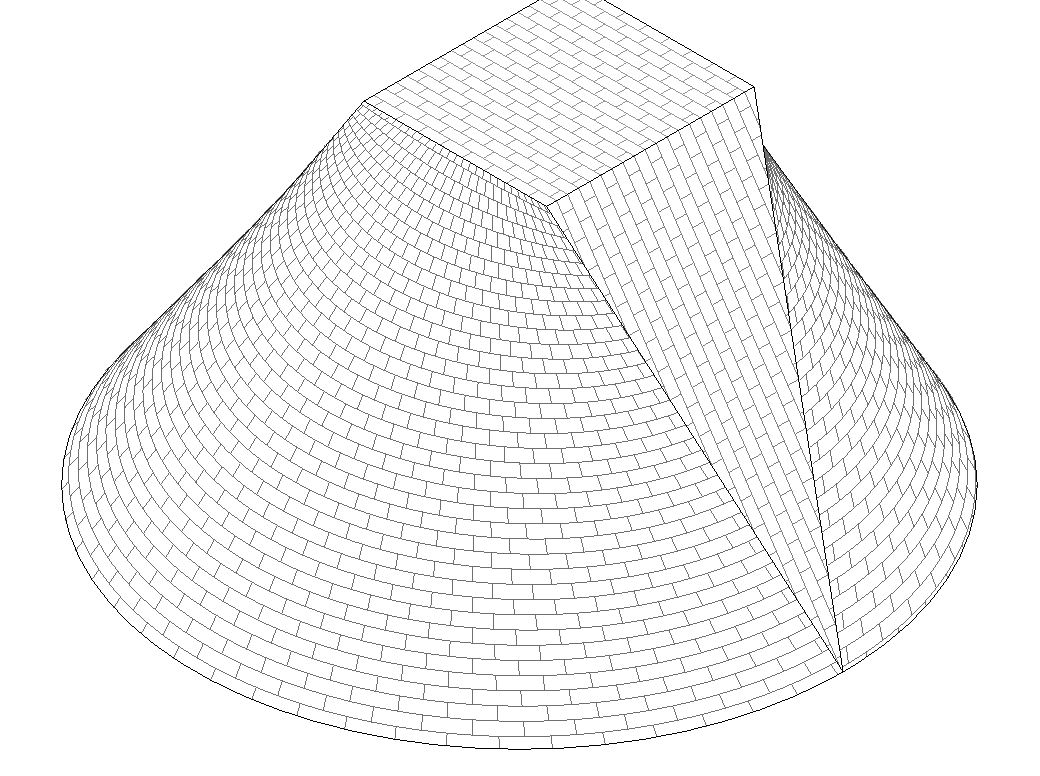

I don't see any How can you expect a linear pattern to work on a surface that may not be flat?  Look at what happens when I assign a block pattern to a blend round to square.  The pattern tries to fit the reducing cone but doesn't know what to do as the square starts to develope.
The answer is - Don't expect revit to work with warped surfaces.

Well, if this was a very complex surface I would agree, but there is obviously some error going on here. Look at the grass texture just beside the bugged out texture. Seems nice right? If revit couldn't handle this, the topography wouldn't be material assignable.
Still thankful for any helpful response.
/Totte

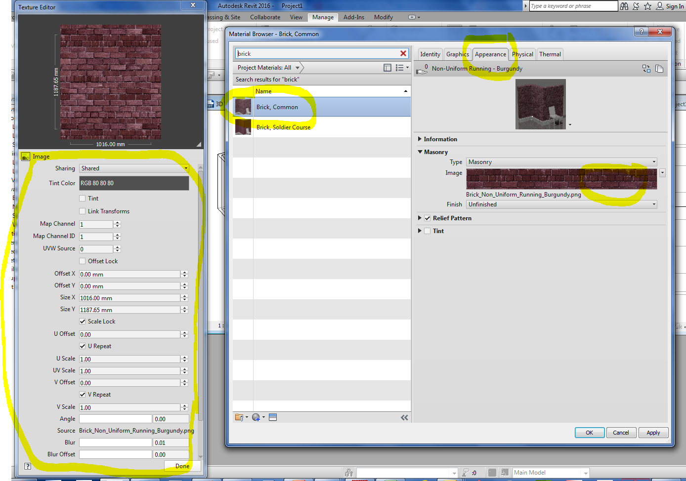

I think there's something wonkie with the material appearance settings. I'd start by trying a different 'out of the box' material with a similar style.
I'd also investigate the Material 'Appearance' Settings. See image below.
