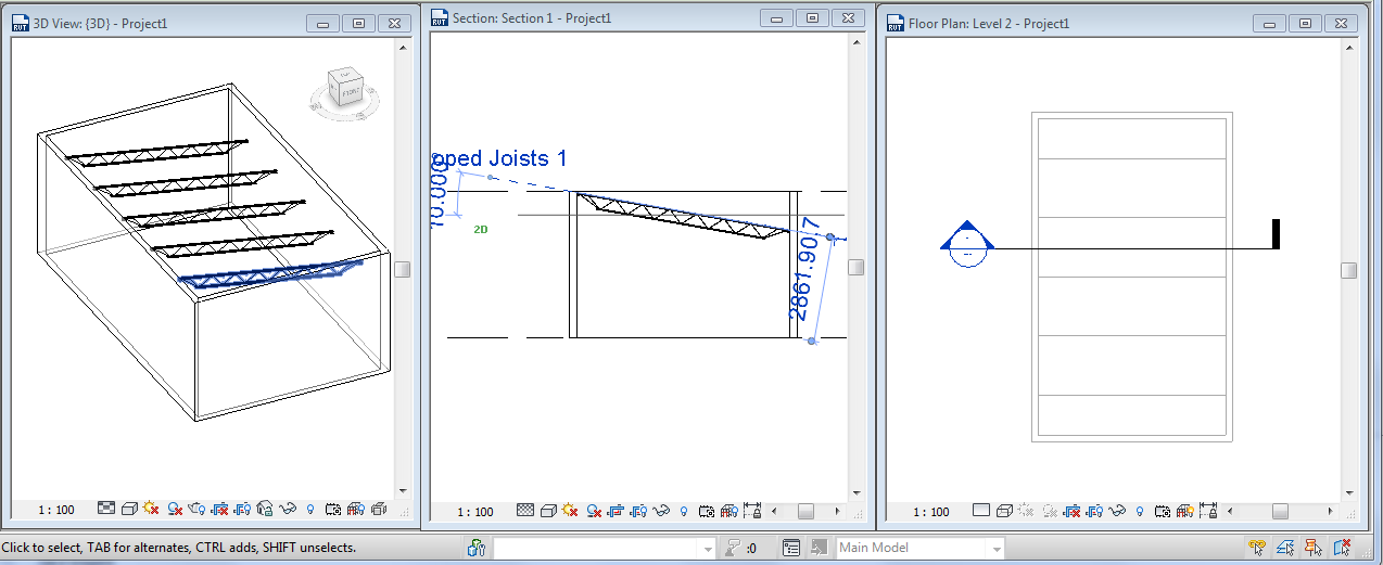

I'm not 100% sure exactly where you want the slopes but in summary you would create the reference plane * and give it a Name in a view perpendicular to the slope (section or elevation view) then in the plan view make that reference plane 'your current workplane' and then draw the sloped joists in that plan view. You won't actually see the refernce plane in the plan view but as long as it's the current 'workplane' then the joists will slope along that named reference plane. See image below where I use an OWSJ instead of a 2x10 and I also used a Beam System and sketch the system perimeter by tracing around the walls with the rectangle tool.

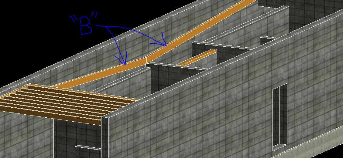

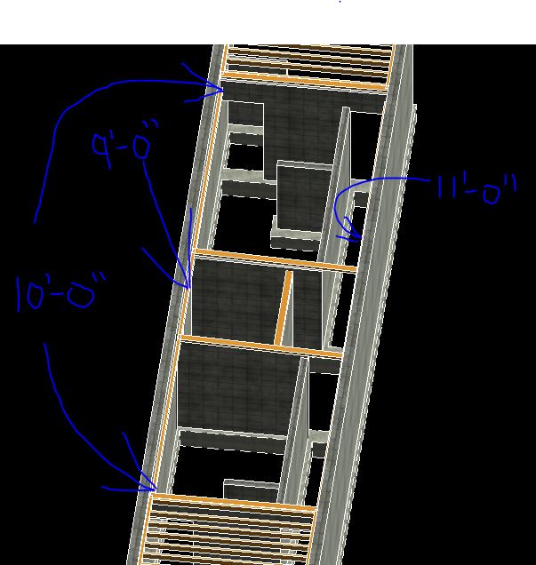

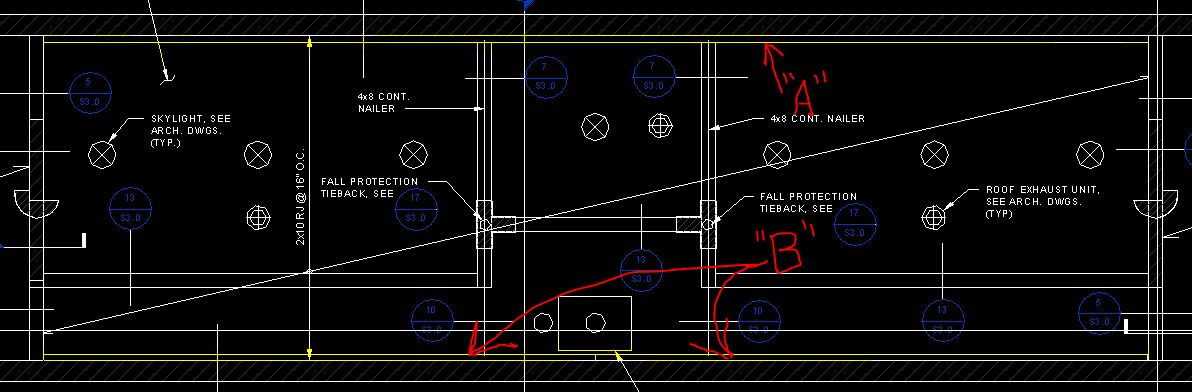

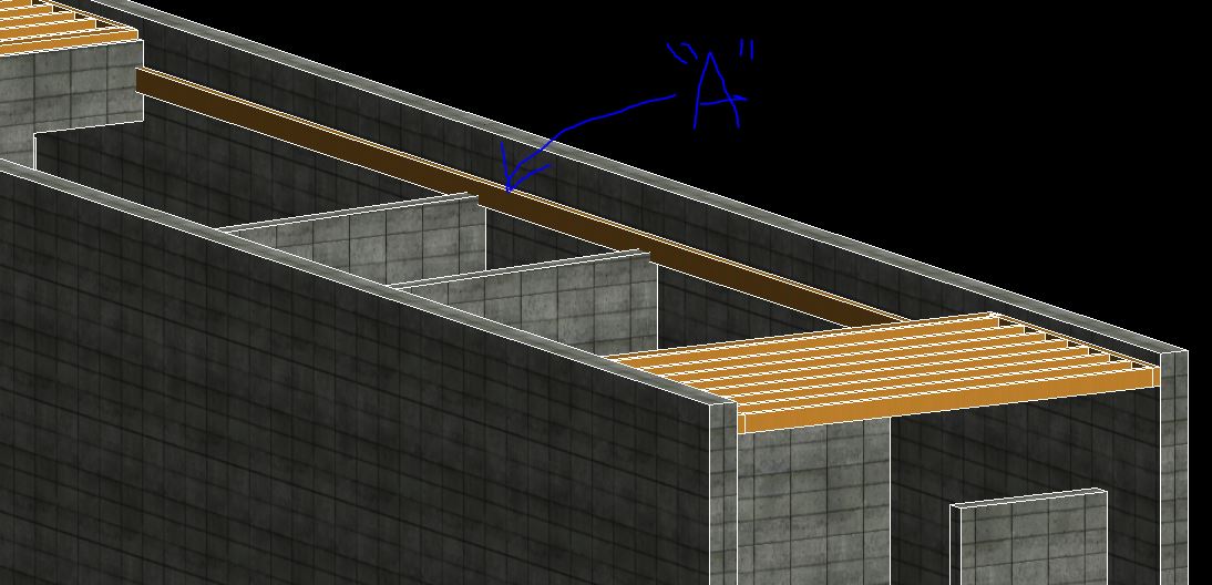

Right but there's no option for 3D snapping when doing a Beam System.  there is for one beam at a time of course.  but for beam system, there is none.
I would think that "Pick supports" means 3D at the very least anyway.  But I just saw that "pick supports" means pick existing members to draw the boundary line and has nothing to do with actually supporting the beams.
so the new screenshots show that the beam system has to span between the two sides of the building and I labeled the supports "A" and "B"
It's really simple, I just cannot get a good 3D shot that shows both supports simultaneously.  so where do I create a reference plane or a working plane?  Why can't the ledger beam be my support so that if I change the elevation or slope, the beams will still bear upon it?

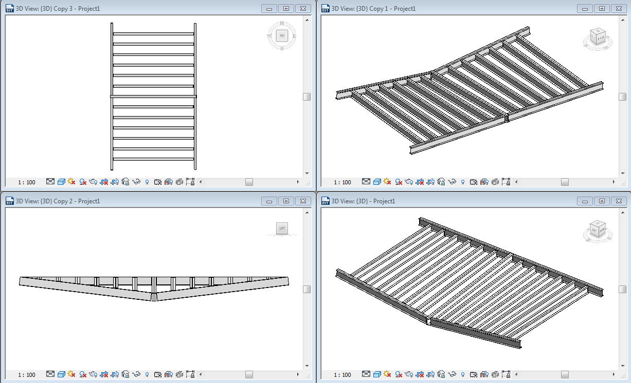

Have a look at the attached image. I created the support beam flat, then used Pick Supports to create the beam systems. Then I lowered one end of the beam by changing it's relative elevation and Voila !

I finally got it.  The prob was I had a different work plane set and didn't know it.
