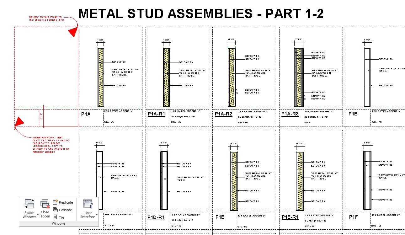

  6. If you are an architectural firm, start working on wall types but this will take time.   I suggest you only have a few basic ones in the template.   We created all of our types and put them in a resource project where they were shown as legends that were fully tagged.   To use in a project, we simply copy the legend with material tags and paste into the project legend.

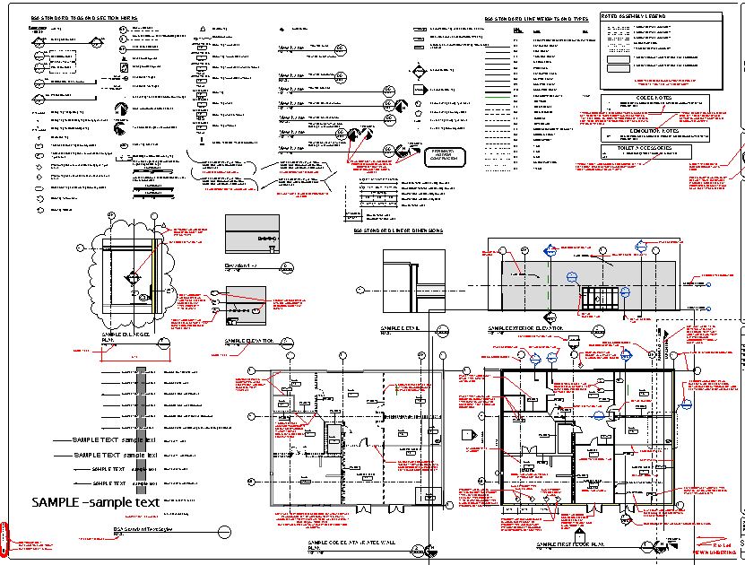

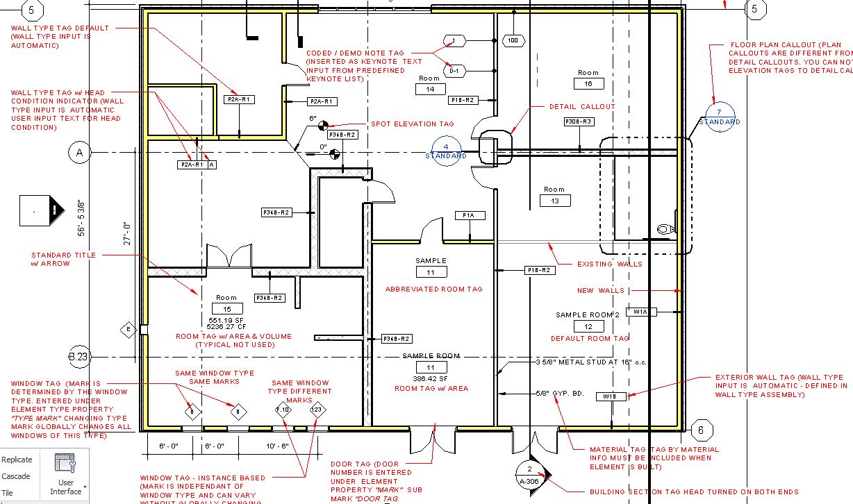

I manage the use of Revit in our office.  We started in about 2005-6 with just 5 users who took one week of training.   We did several projects before we tackeled our template.   You really have to understand how to use Revit before you paint yourself in a corner spending a lot of time developing bad content or bad habits.  This core group together contributed different portions of our template.  We also trained our staff or 40+.
I had uploaded an image of my first project that I did completely with Revit by myself.  It was a precast parking garage that integrated with a Hotel I was doing in CAD.  Here it is:
Our office had a notebook of our CAD standards.   Over those first few projects, we had created many of the standard annotative elements we would need.  We expanded on that and published our standards in a Revit project so new staff could refer to that as needed.  See attached.  Red notes are all explanations.

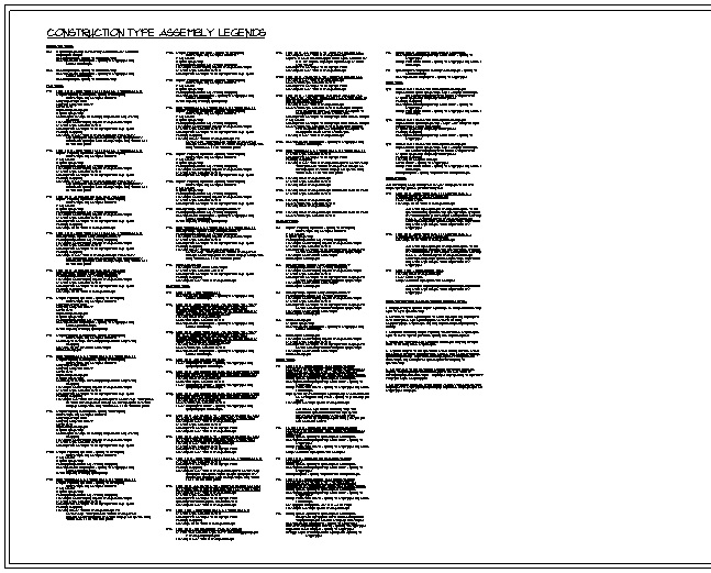

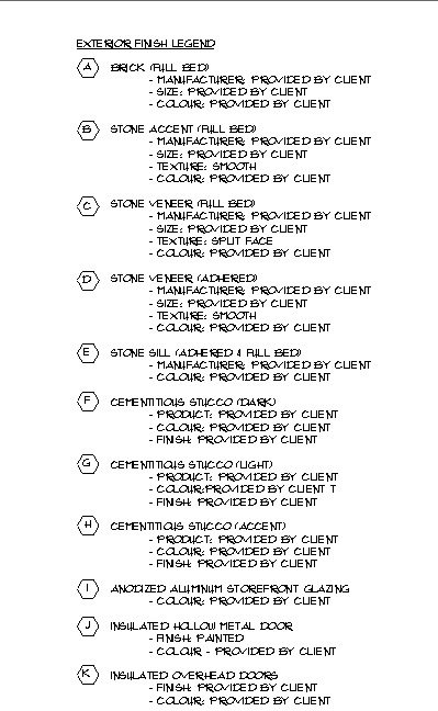

Two things i've always wondered is what is the best way to full automate construction type legends and exterior elevation keynote legends.  I've attached some images of what our office did for our first project (ie: tried to make it look like AutoCAD).  I know that there needs to be a more efficient way to do both but havent had much luck in my research.  Do you have any suggestions ?

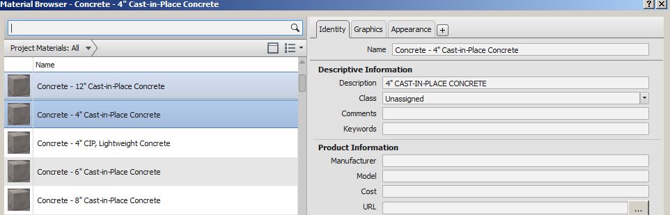

Those legends are simple text/line legends and there is no way to automate that.  You can transfer legends between projects.
We use the power of Revit to describe our wall assemblies.  These are Revit legend components with material tags.  The information comes directly from the material.   This takes awhile to get in your template and to train your staff.   IF YOU EDIT ONE OF THESE MATERIAL TAGS - IT CHANGES EVERY TAG ATTACHED TO THAT MATERIAL IN THE PROJECT!  We only use the Description for our tag but you could use some of the other fields where appropriate.
