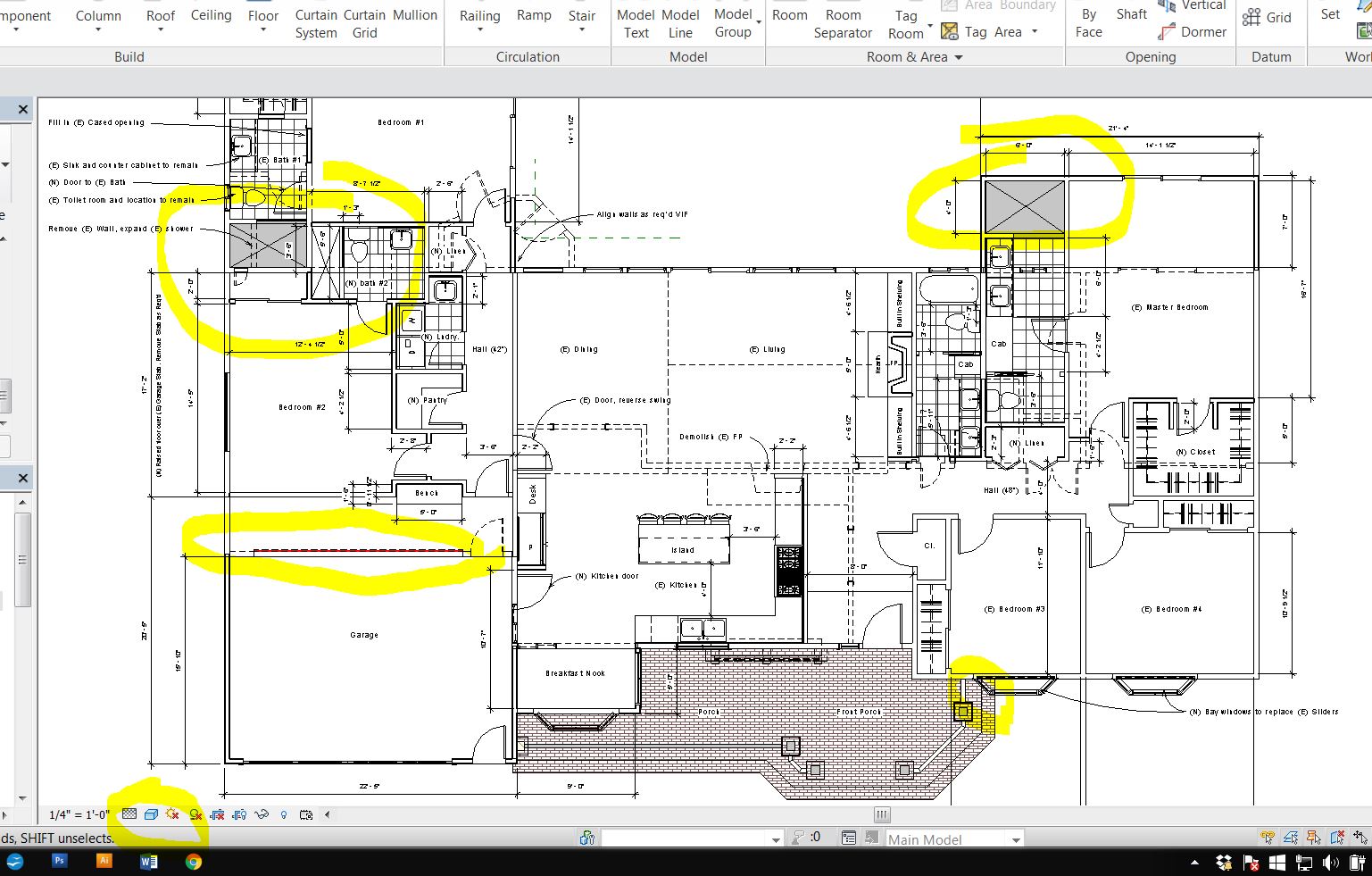

So I saved a new version of a project. and somehwere it decided to get all buggy. Ive restarted etc. but can't figure it out. the plan view wont change graphic styles. ie. shaded, hidden, wire frame. As you can see on the screen shot, its set to shaded. yet all it does is grey a couple items. window is still wire frame. red on the demo garage door. ive checked the rpevious saved copy and its fine. The settings on the views havent changed. is this a bug or does anyone have any advice.
Edit: OK, sorry found it. I  used the "override graphics in view" but I accidentally chose catergory and not element when I was trying to get one thing to be transparant. so it altered the whole view. was kicking my butt trying to figure it out. gotta watch the settings choices. can be complex.
