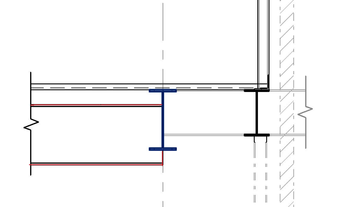

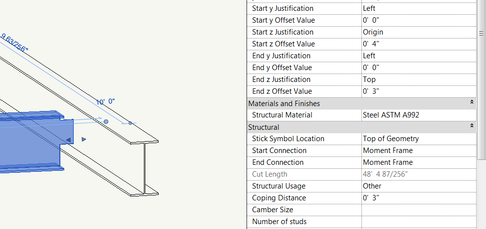

Hi guys,

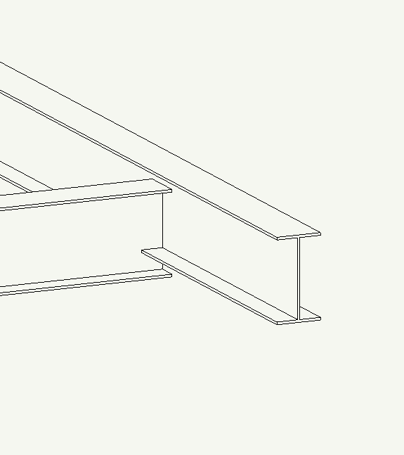

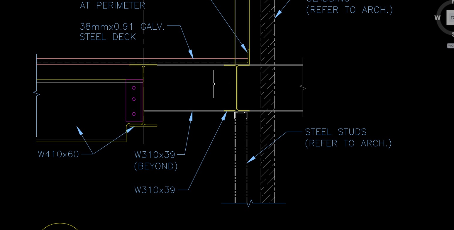

I've noticed that this has been a question before but I have a different problem.  I want to cope the flange of my lower beam into my higher beam.  The first picture shows the high/low beam scenario, the second picture shows what Revit does after the cope tool and the third picture is what I need it to look like.  Any suggestions on how I can do this?
Thanks in advance!
Thu, Dec 10, 2015 at 2:41:59 PM | Cope Flange/Beam

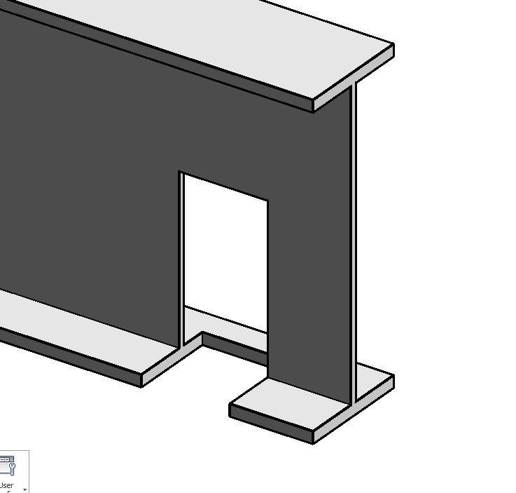

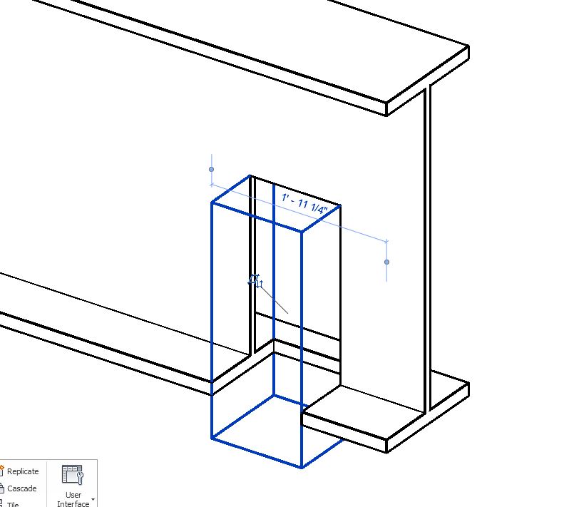

Obviously, your needs are not met with the standard cope.   Use a face based void family to do your work or a model in place.

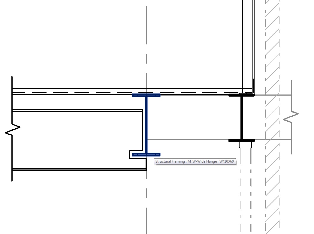

  • Try adjusting the coping values in the properties window.
  • If you were to model in place and cut with voids, you would lose a lot of other functionality with the structural tools.
