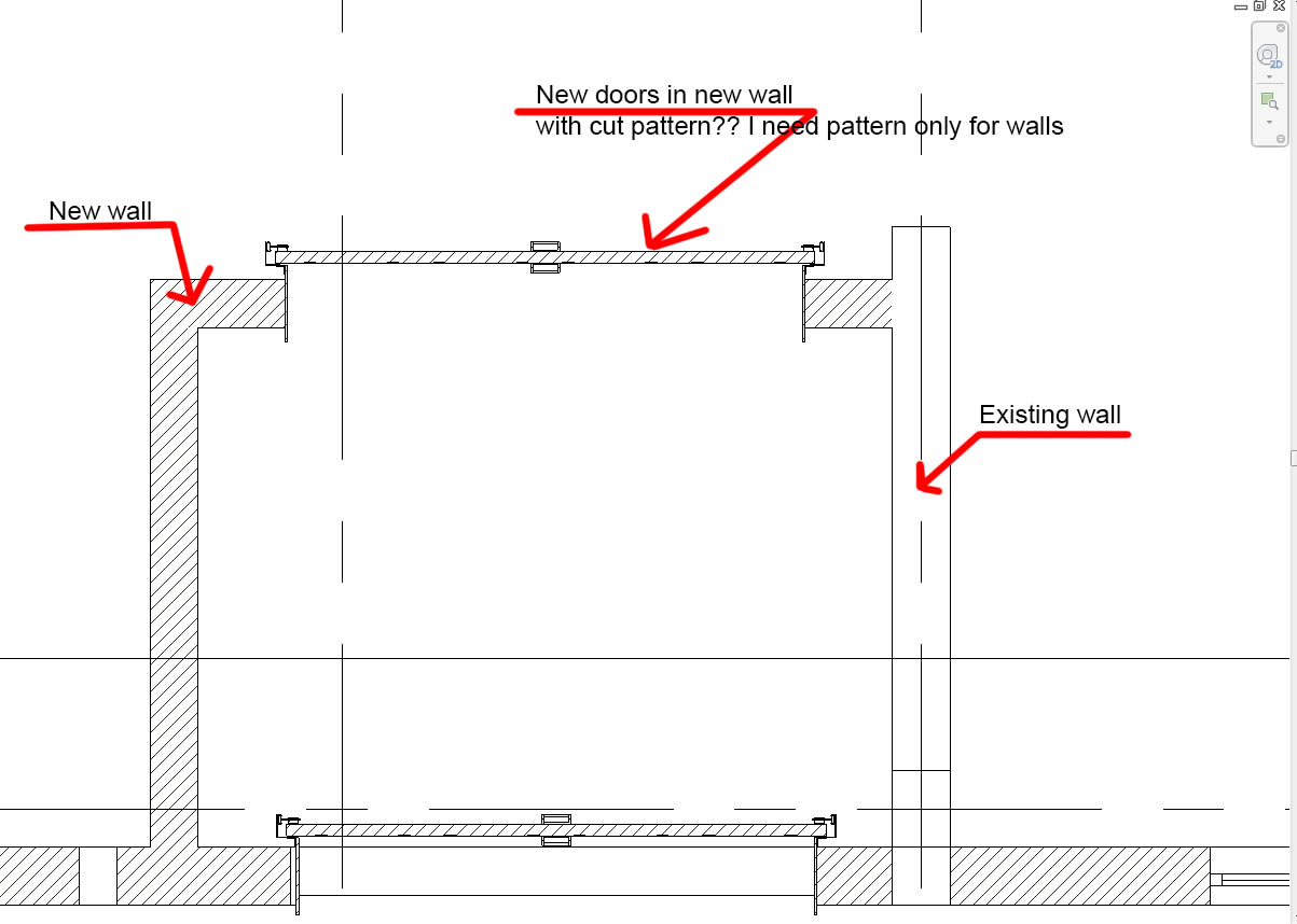

How can I get rid of displaying hatch in doors, pls see IMG New construction phase, New doors in New wall has same hatch. So Dooors in plan looks like a wallSad help

You can override the doors with a solid white hatch in the cut setting for instance, in the view template, or directly overriding each door.

thanks!

Instead, change the material for the door panel to one that does not have a cut hatch pattern defined.
