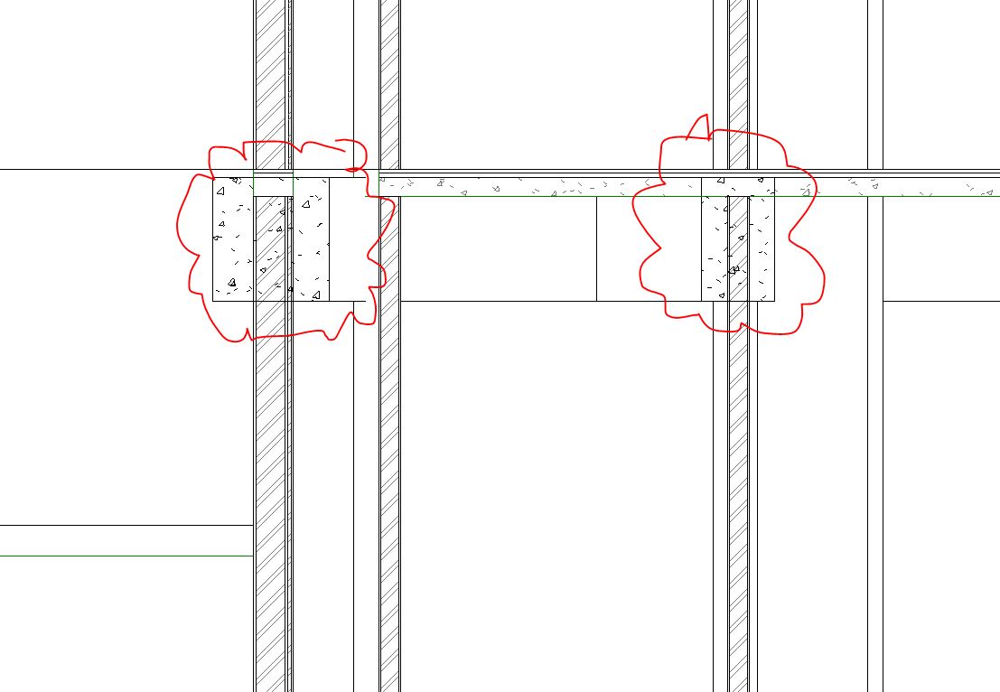

Dear all,
I'm new to revit and had trouble doing the section , tried searching it on google but no result..
Is there any way to stop this (image attached) wall to collide with the beam? I wanter the wall to be automatically stop below the beam..

Hm,just tried join and worked..

you can use the align tool. which is under the modify tab.
In section if you use align and then click the underside of the concrete beam and then the top of the wall it will line the wall up to the bottom of the beam.
