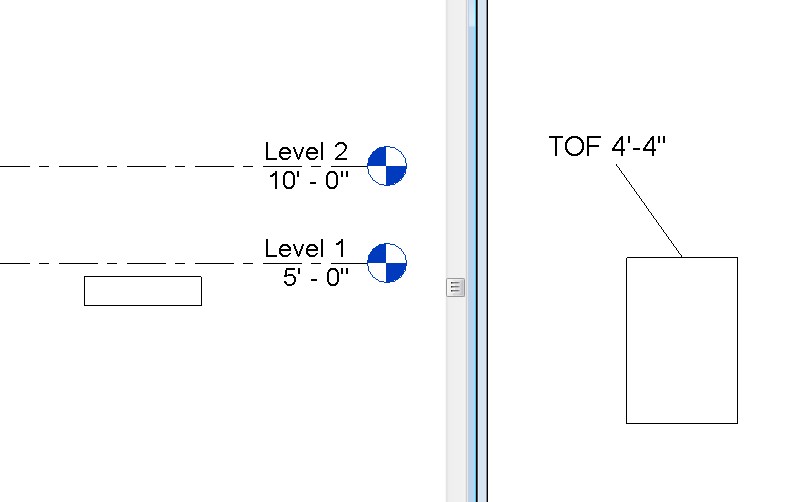

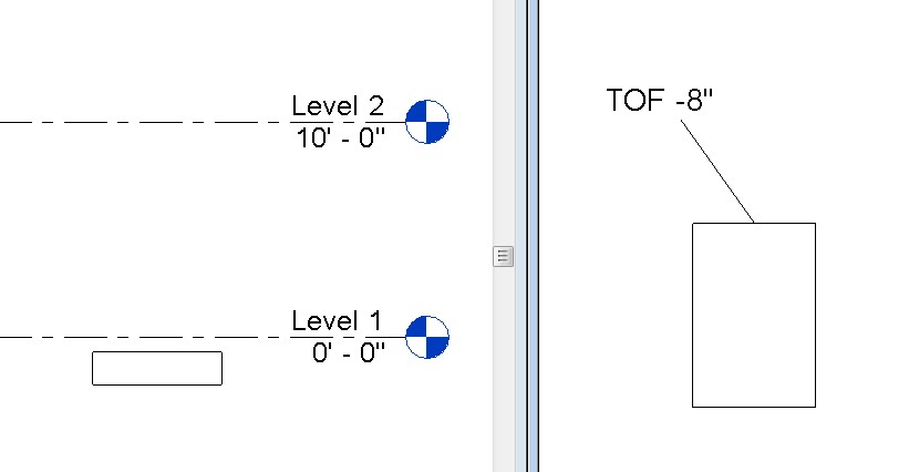

I want my foundation Tag to read -8", -3'-4", etc. (top of elevation, from level)
When the level is set to 0'-0", it works as desired.
If the level is set to something other than 0'-0", it does not.
What am I missing?

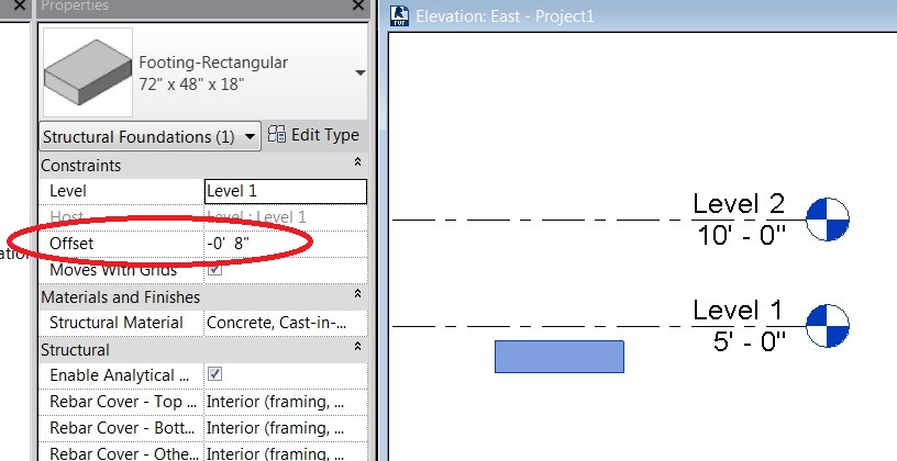

Also/or
Is there a way to get the "offset" parameter to be part of a Foundation Tag? I know Structural Framing Tags allow you to read the "z-offset". This would also solve my issue if it can be done.

My tag is a Structural Foundation Tag that reads "Elevation at Top".
The current project I am working with has the main floor elevation as 1,697.00'. Whenever I use the tag for a footing 4'-0" below floor elev. it displays "1,693.00'" instead of -4'-0" that I would prefer.
It's just more confusing for everyone, contractor included, especially when you get into feet and INCHES.

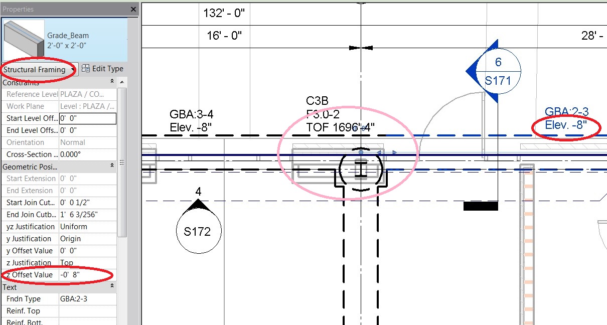

Here's my project.
My "grade beam" is set as "structural framing" so there is a "z-offset", which I can use in my 'structural framing tag'. This gives me the nice -8" number I desire.
The "footing" in the pic is set as "structural foundation" and thus there is no z-offset, but there is an "offset" property. However there is no way to tag this in the 'structural foundation tag' (that I am aware of).  I'm having to use the "elevation at top" field, and it tends to display the actual elevation (much like a spot elevation I imagine.)
