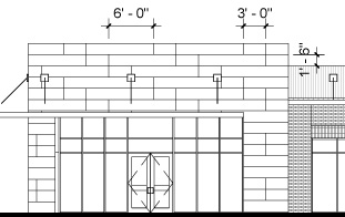

I'm basically trying to creat a larger running bond pattern.  I started by copying the 8 x 16 CMU text in the .pat file and changed the numbers to what I thought would get the larger spacing:
*Clap Board 18x72,  18 x 72 blocks running bond
;%TYPE=MODEL
0,             0,             0,             0,             18
90,            0,             0,             36,             36,             36,             -36
However, my results are not what I'm looking for.  See attached.  What am I doing wrong?
I've read over the instructions at the top, but I suppose I'm completely missing something.  Thanks.
I'm in 2015.
Mon, Nov 23, 2015 at 1:08:50 PM | Pattern - Running Bond
Your first 36 in the second row needs to be 18

I had thought that too, but it winds up with the attached pattern.
I'm trying to get 18" in height for horizontal lines, by 72" spacing of vertical lines.
See attached.

This being the pattern:
;%TYPE=MODEL
0,             0,             0,             0,             18
90,            0,             0,             18,            36,             36,             -36
Mon, Nov 23, 2015 at 2:28:23 PM | Pattern - Running Bond
Sorry ... I missed this
0,             0,             0,             0,             18
90,            0,             0,             18,             36,             18,             -18
