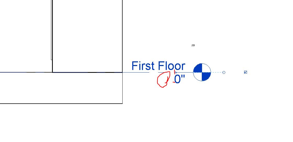

How do I get this to show?
See picture. elevation feet is hidden? or off. Can't find the option so it says 0'-0"

Edit your level head family and edit the elevation label.   See the hand with the # sign?  Pick that to change your units and uncheck - suppress 0'
