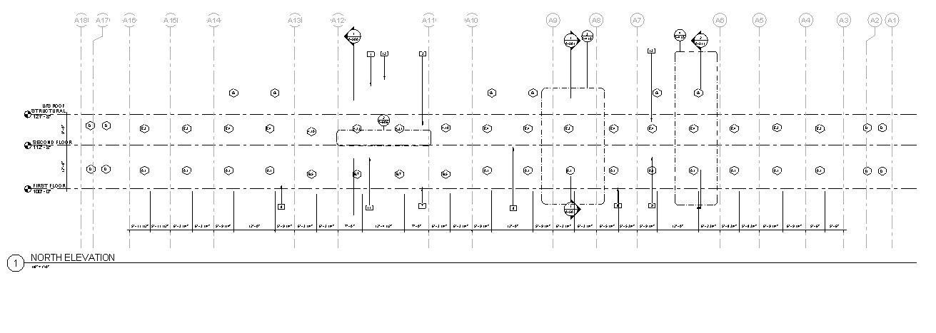

I have an exterior elevation view on a sheet which can't be shown correctly in preview, also can't be printed. It seems like the elevation is on a def. layer or something which can't be printed. I attached a screen shot for your reference. My other elevation views are fine on the sheet.

Wht was that image supposed to show us?
Many things don't show up in preview but that typically is never a problem.
Do any of your other views have sketched boundaries that may overlap this view?
Put the view on a new sheet and tell us what happens.

Yes, I tried to place this view on another new sheet and the problem is the same. The elevation view looks fine on the sheet, but just can't be printed. When I tried to print either the sheet or the view itself, nothing showed up except dimensions, tag, grids & levels.

I had the same issue happen on a sheet that I was trying to print. I was able to solve the problem by adjusting the crop region boundary control points.
