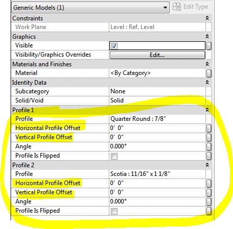

Hi All,
As the title suggests I am trying to work out how to offset the ends of a blend from thier center points via a parameter that can be changed at will.
Does anyone have any tips on where to start?

Sorry, misunderstood your question. Create swept blend with straight path then. Insert profiles (do not sketch) and the offset parameters are already done for you.

Was not sure how to get a swept blend to work as I have never used it before.
I managed to achieve my offset paramater by overlaying 2 reference planes and adding a paramater to control the them, then attacheding the center of one end of my blend to them.
This seems to work fine.
