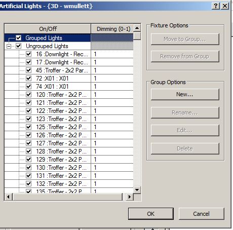

I already checked that it has a light source. It has one, but doesn't look like it's correct for the fixture, and nothing I do changes it. (The first Image)I have been rendering under draft mode, but with Artificial: Interior Only as the setting. (the second image). The large circular fixtures (that look like wood) are the ones that are not working.
Wed, Nov 4, 2015 at 2:53:15 PM | Lighting Units not Rendering
I'll try this one more tme - are your lights on?
Fri, Nov 6, 2015 at 9:29:57 AM | Lighting Units not Rendering
lesgos
Joined: Mon, Nov 2, 2015
0 Posts
Yes, all the lights are on. Grouped and Ungrouped are all checked.

As I stated earlier, the light source has to be visible and not hid by any solids.  The light source in this family is inside the ring.  If you delete the ring and re-import the family, the light family does illuminate but only at that single source.
So, as I also said, many manufacturers don't know how to build these families.   This light has an imported solid that you can not control the material.  This light also needs multiple nested lights that are strip lights, not point source lights.  Not an easy family to build because the strip lights have to reside within the geometry.
