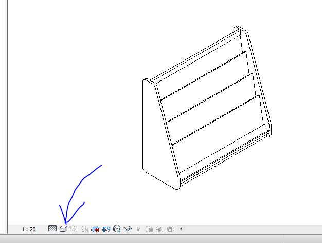

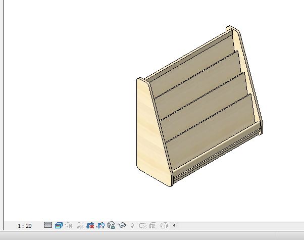

I have a feeling you just need to change your Visual Style from Hidden to Realistic. I have uploaded two pictures below to show you where you can change visual style.
Hope this helps.

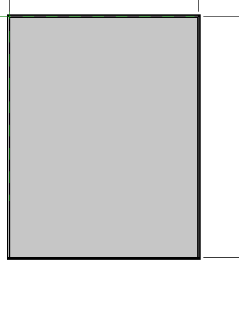

Thanks for the help, but it's still not working.  I set it to realistic, and it looks like the file attached.  Any other ideas?

Hi Emma,
Could you attach the family?
I'm assuming when you ahd the drawing in Hidden Line that is when you had the "the images always come up white.  No design, no nothing.  Just the basic outline in black. " or did switching between the views not help?
Re-reading your post, when you "images" do you mean materials / pictures on the item?
If so, maybe this link would be of help?
https://forums.autodesk.com/t5/revit-architecture/insert-image-to-revit-family-and-save-as-family/td-p/4434307

@Shatner86:Thanks so much!  I checked out the website, and that was what I was looking for.
