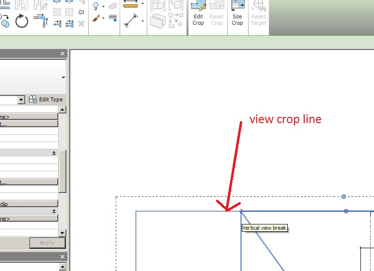

I have my floor plans on my sheet but my property lines exceed the width of my sheet so you do not see the full extent of the property, which is fine. I have to be able to dimension from my property line to my setback line and have it display on my sheet. When the crop is activated it makes the dimesnion completely disappear. is there anyway to override this and make the dimension partially show on the floor plan?
Wed, Oct 21, 2015 at 2:00:24 PM | Dimension Crop Box

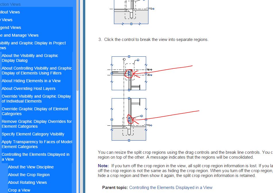

Use the view break on the view crop to break the view into two parts and to keep your property line and thus your dimension.
Read this help:

Would you happen to have another suggestion. If I do it that way the second part of the drawing will be off the page, and when I go to print it throws my drawing off center.

Grab these blue arrows and pull the parts closer together
Wed, Oct 21, 2015 at 3:17:51 PM | Dimension Crop Box
Read the HELP please!  You can adjust the break point and move the split windows together so that both ends of your property are close enough together to fit on your sheet.
