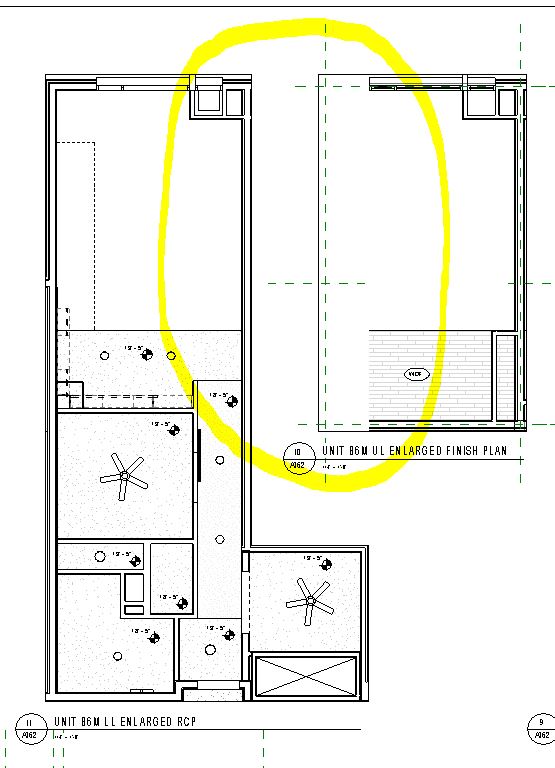

Has anyone ever encountered this issue? I have views on a sheet cropping out information from eachother. The polygon crop tool was used, the annotative crop is not in the way, and it's not the viewport because that doesn't line up with where the other drawing is being cut. I checked for a plan region that may be interferring and that came up negative as well. Any help would be greatly appreciated. I feel like there would be no point to the polygon crop if this weren't fixable, so there must be some solution that I'm missing.

Revit version is 2015 just FYI
Wed, Oct 21, 2015 at 1:21:12 PM | Views on sheets cropping eachother
You need to understand that the sketched crop simply adds a masking region.  That is what is hiding the other view.   Views on sheets did have a placement order for what's on top.  You might play with the order you place the views on the sheet.

Wot he said. Remove the views from the sheet & begin again, changing the order of views placed on the sheet. Had to do this a lot.

We have had issues using the sketched crop region in general. Causes crashing and can create MASSIVE PDF files that will bring things to a hault. It's not the  answer you want but we had askedeveryone to NOT use the sketched crop region. Not sure if that has improved since 2014.
