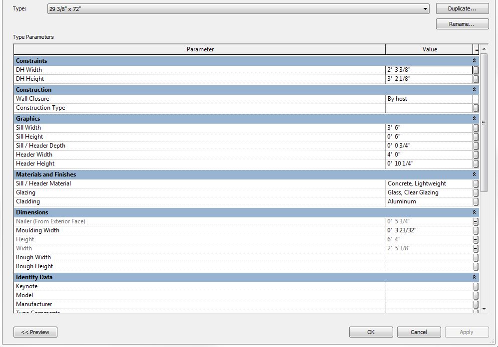

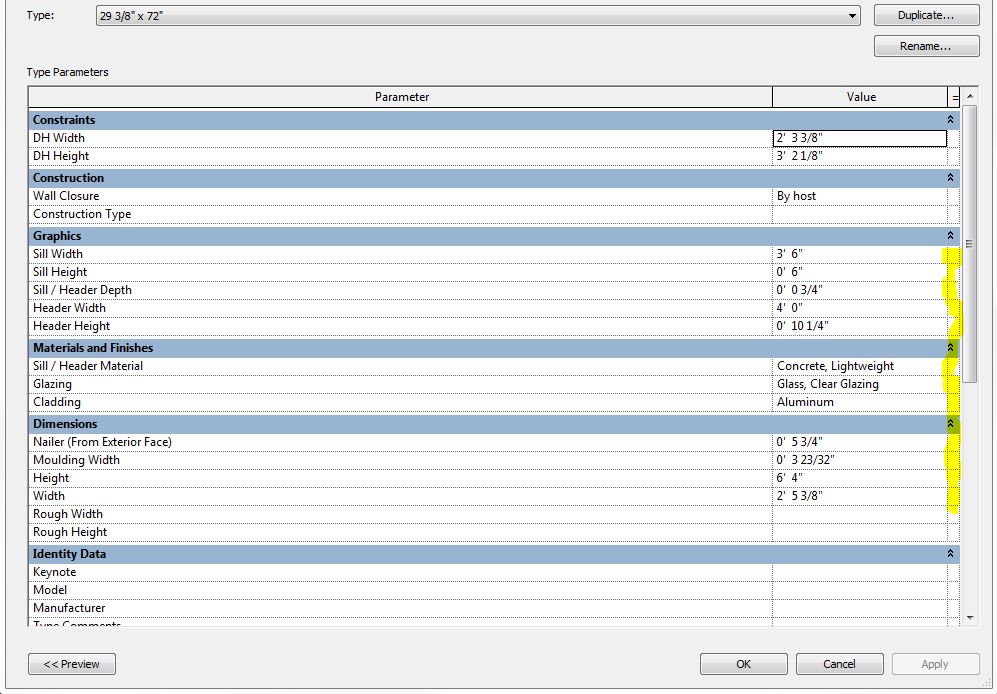

The firm I am working for prefers to schedule windows individually, even if there are multiples ganged together. Therefore if you've got a single 2 x 3 double hung as "Type A" window, and then a triple window of the same size, they just tag and schedule that as 3 type A's, not a new window type.
Obviously this makes things a little more complex in Revit. I made a new window family and nested the window I wanted which made up the triple double hung. I also made sure the windows were "shared" so they could be scheduled individually.
My concern is that I can no longer make the parameters of the nested windows part of the parameters in the family they are nested. What's up with that?
I attached an image of the triple window where the nested windows are not shared and one where they are shared. You can see it no longer gives me the option to use the parameters of the host family.

With shared nested families, only instance parameters can be transferred to the parent family. You can change them to type ones you’re done with creating/associating new parameters in parent family.

Yeah that's exactly what I thought but notice how the little grey button doesn't exist fo rmy nested families in that one image?
As I look closer it appears you can only use associated parameters with instance parameters of nested families. So that means for any family I nest in a hosted family, those parameters have to be instances to be controlled by associated parameters in the host?

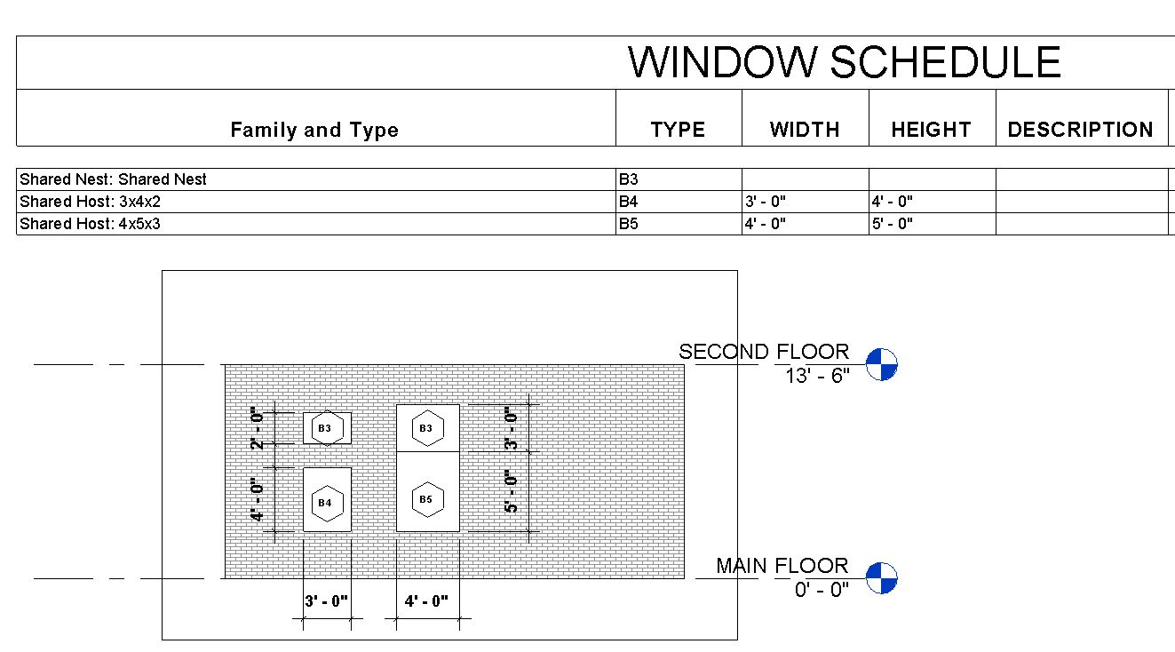

Hurdle #2 is now how the schedule reads this family. It recognizes the windows separately which is good. BUT, the Width category can only read the Width parameter from both the host and the nested family. The width parameter in the nested family is no longer relevant but it is still being read by the schedule.
So the solution is either to add another column to the schedule which would read the transom width (though this could easily confuse contractors) OR my other solution of creating a completely new family from scratch and letting the Width parameter be an instance and therefore would always read correct in the schedule.
Any other suggestions to have the schedule only have one window "Width" parameter and correctly read the hosts and nested families?

So I used my method of starting with a generic face-based family for the nested family (a transom window), imported to the host family (the main window), associated and set all the parameters, brought it into the project, tagged then scheduled it... and here is what I found:
Revit still can't discern between differing types of the nested family. So while it can tag the different types of the host family differently (B4 & B5), it still tags the nested family the same (B3), even though the sizes of the nest are different. This completely screws up my original theory and I am back to square one.
The only solution I see here is to just place transom windows in your project as their own family but this now means you are doing twice as much work (making sure they are aligned to the window below, getting the correct sizes, etc.)
Any other solutions??????
