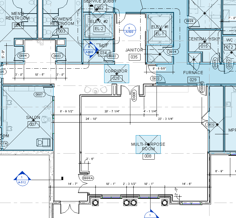

I have a quite few rooms are not correct enclosed. I've checked all walls' room bounding including stacked exterior walls, but just can't find what's wrong. What I missed?
Fri, Oct 9, 2015 at 12:11:11 PM | Rooms errors
rabbitcookies
Joined: Sun, Feb 7, 2010
5 Posts
Okay, I found out that a piece of stacked wall is not room bounding. I never changed the room bounding setting for all stacked walls, but why some stacked walls are not room bounding, some are?  What cause that?
Fri, Oct 9, 2015 at 1:08:44 PM | Rooms errors
A stacked wall is simply that - a stack of individual walls each with their own settings.  You are the one that sets those parameters.
