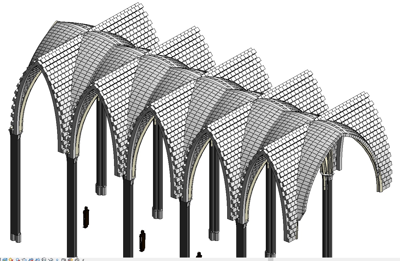

So I am working on a Chapel, and we are designing the roof for a Nave. We need to pour an 8" slab over complex curved surfaces so that stone can be seccured to it. I am having a hard time getting this done in revit. I suppose it could be a different type of component, but i need to show an 8" surface over the top of the surface shown. (see picture) I appreciate your help. If you can help me accomplish this, you will truely be a revit master.

Maybe you got this backwards... decide how first before you model.  The Concrete could be a simple layer of a roof.

That wont work, I think because it is to complex. Any other ideas befor i declare this impossible?

Absolutly not too complex unless you are not telling us something.  If you modeled those brick like elements then that is a big mistake.

you can use roof by profile, you will get two roof objects for each galley.

Additionally, you could do a roof by picking the face of a mass being used to drive the overall shapes of the vaults. The process is important like WWHub said. Based on that, there many ways you could do this.

send capture of existing roof details, including Edit Assembly of Roof Properties
