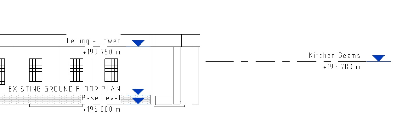

The attachment called Level Heights shows my levels sitting between 196-200m (196000 - 200000mm).

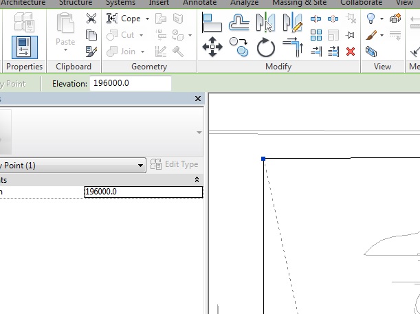

The attachment called Toposurface Levels shows an exaple of the levels sitting at similar height to my elevation levels (e.g. 196000mm). i.e. the toposurface is supposed to be at similar levels to the elevations.

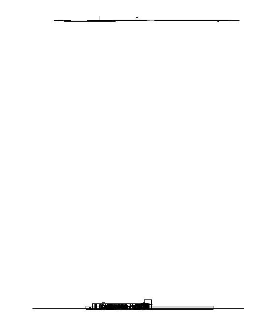

The attachment called Toposurface in 3D shows the current relationship between the same toposurface and the levels. Completely unaligned.

Revit is doing exactly what you have told it to do.
When you create topography initially using points, it is all relative to your level one.   All point elevations are relative to that.   If you later relocate your project, the model components and levels will move but your site will remain where it was.  It is always better to create your topography from a survey import because of this problem.
Changing your point elevations is still relative to that initial level one location, not your new elevation.   You will have to drag your topo down to the correct location. Or maybe better - recreate it from the survey points now that your project is located correctly.
