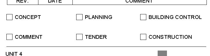

Hello So my practice has drawing sheets in various sizes as am sure we all do. In autoCAD each sheet had a box that noted the project status so... Planning... Building control... Tender... As built Depending on the status we would solid hatch the box relative to it... In Revit we are struggling to create this parameter. Does anyone do this similar or have an idea how this can be facilitated? Thanks...

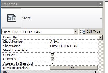

We have a simple parameter asigned to sheets that tells the sheet status.  It shows up under properties.

Hi Thats exactly what we need to.
Is your parameter a text box because we have looked at that?
Ours is as the image and we are looking for the boxes to be hatched depending on status...
Mon, Sep 28, 2015 at 8:43:30 AM | Layout sheet - project status notification.
Like this?
Project Parameters / Instance / Assigned to sheets / Grouped under Identity / Y/N Field
Mon, Sep 28, 2015 at 8:56:57 AM | Layout sheet - project status notification.
dvgareth77
Joined: Fri, Mar 20, 2015
0 Posts
5 Stars: 1 Votes
:-) Yes exactly!
