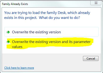

After I updated the identity data in a family, such as the manufacturer from AAA to BBB,  re-load it into a project, and click the "Overwrite the existing version". However in the type properties that manufacturer stayed the same as AAA.
I had to delete that family from the project, re-load it into the project, and then the manufacturer changed to BBB.
Is that the only way? Or, did I miss something?
Any helps appreciated.

Pick second option when reloading.

Thanks! How could I miss that?
