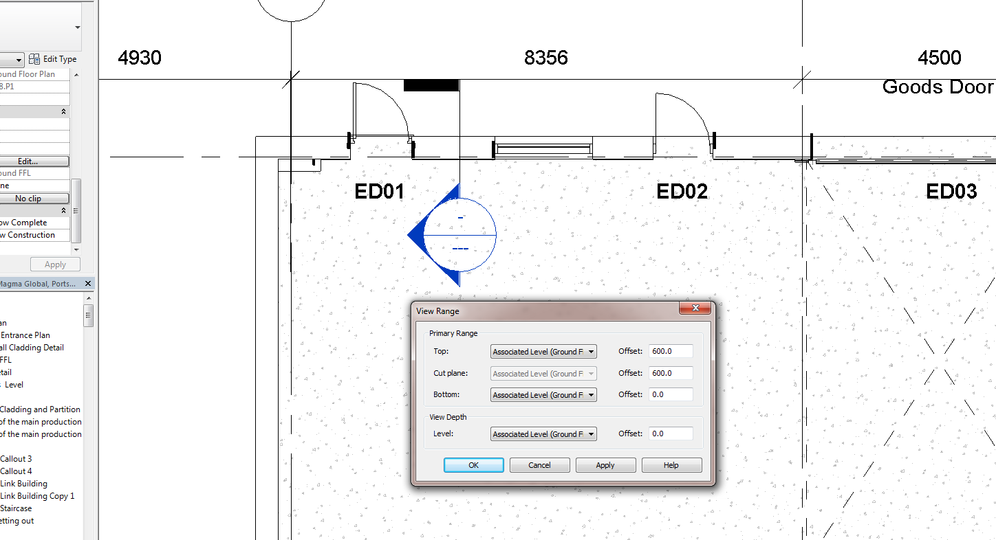

Morning guys,
Having a real hard time working out what's going on. On my model there is a brick plinth that is 850mm high from ground level. Above that is composite cladding which currently shows cut on plan. I tried changing the view range so that it cuts through the brickwork on plan rather than the cladding so i set the cut plan and top view at 600mm which usually does the job but what im left with is a top view of the brick wall make up with no cut hatch pattern (blockwork, cavity, facing brick).
I've checked the VG settings and hidden items just for the sake of not missing anything silly but as it stand im just seeing the top surface of the brick wall rather than the desired cut view on plan.
Hope this all makes sense.

Tue, Sep 22, 2015 at 7:23:55 AM | Plan view not showing cut wall
Revit has always had a problem with short walls.  My typical solution is to make the wall taller and use the wall sketch to make it be the correct height.

Worked like a charm WWHub, brilliant stuff. Thanks
