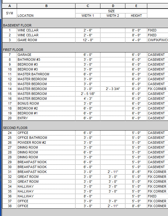

Is there a way to get both width dimensions to scedule for a corner window? Even if I have to manually enter the second dimensions. I am looking for it to look something like this. Thank you!

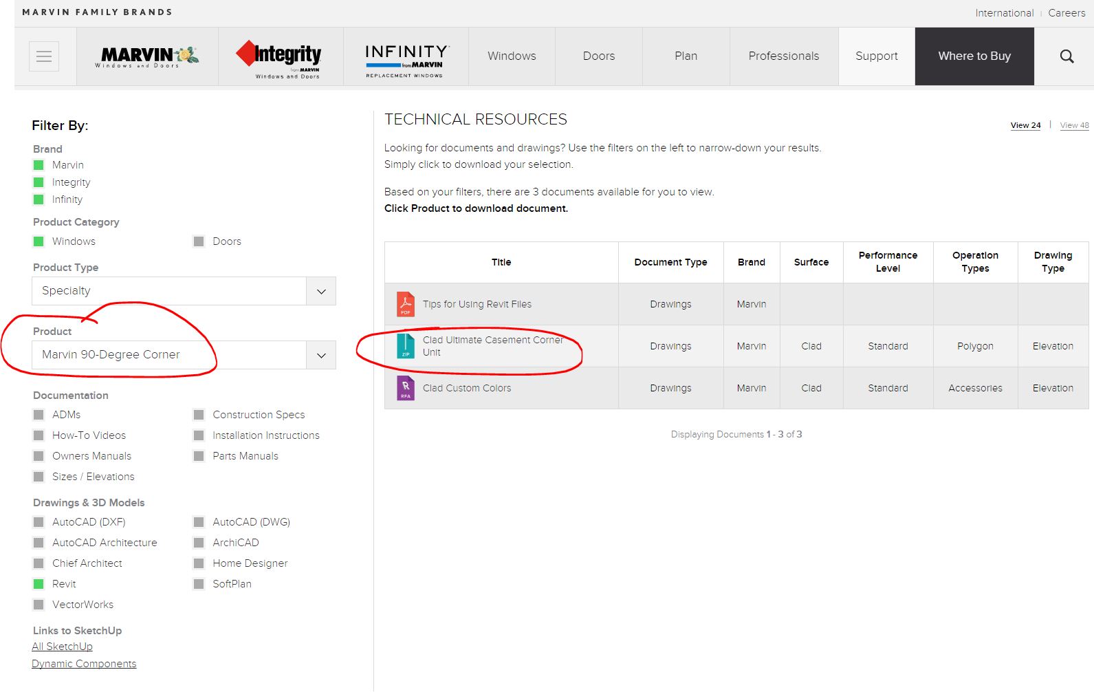

It depends on how the window family is built. See this. It will give what you need.

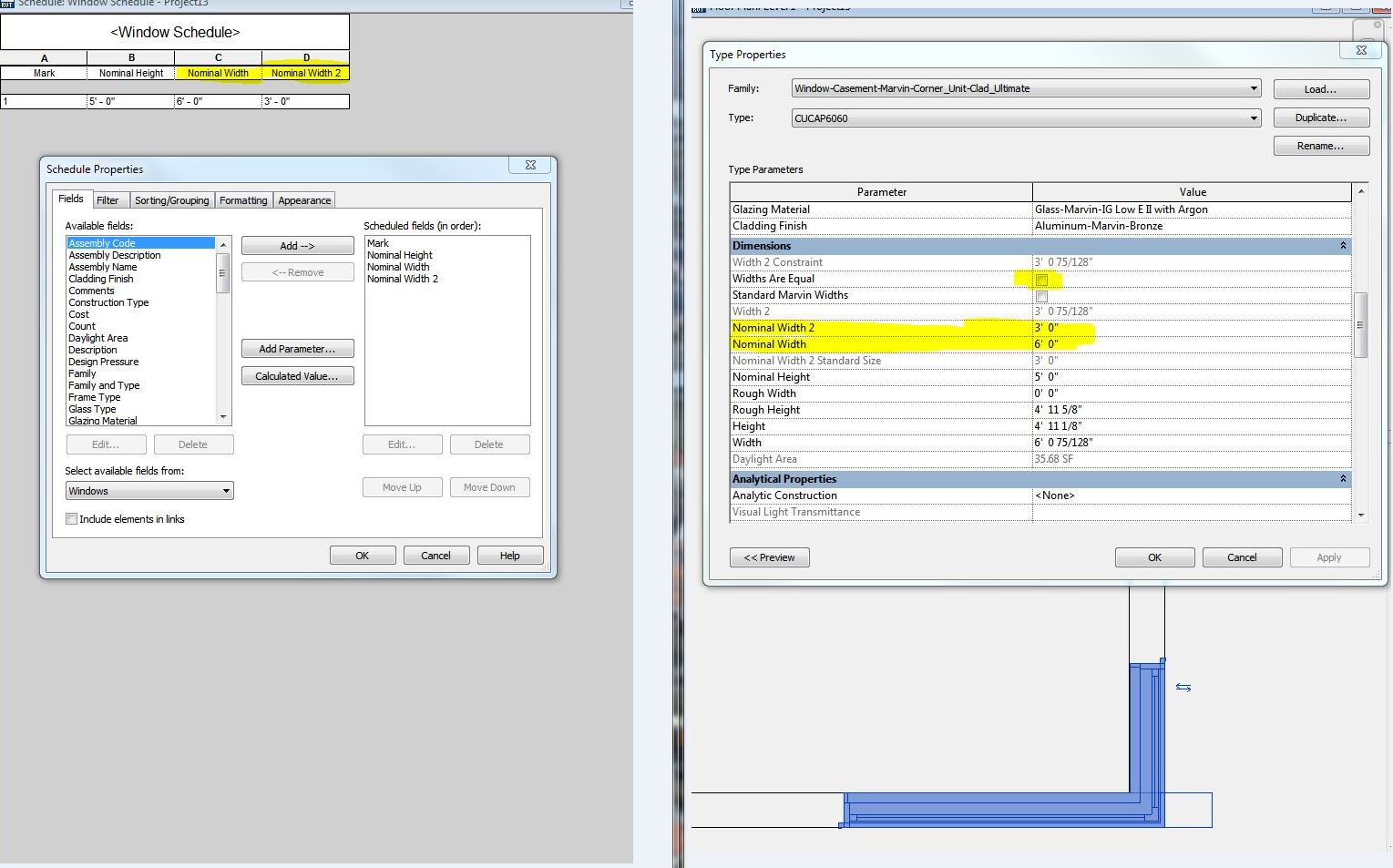

It looks like you haven’t looked at the family carefully enough – see picture.
If you have your window family built already, add second shared parameter for width 2.

Awesome!  Thanks pijpiwo, that got it working. I'm still a newbie when it comes to shared parameters. I always forget about them. i'm not usre about how to specify right and left but width 1 and width 2 will do for now!
