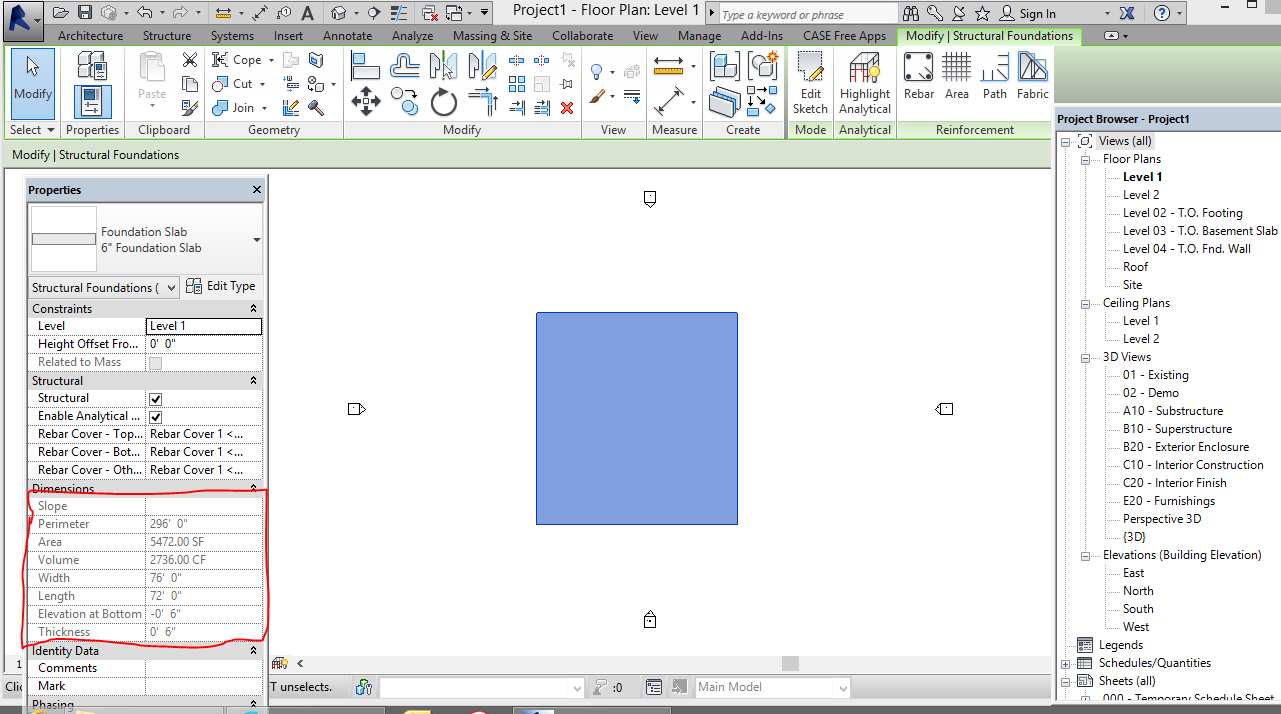

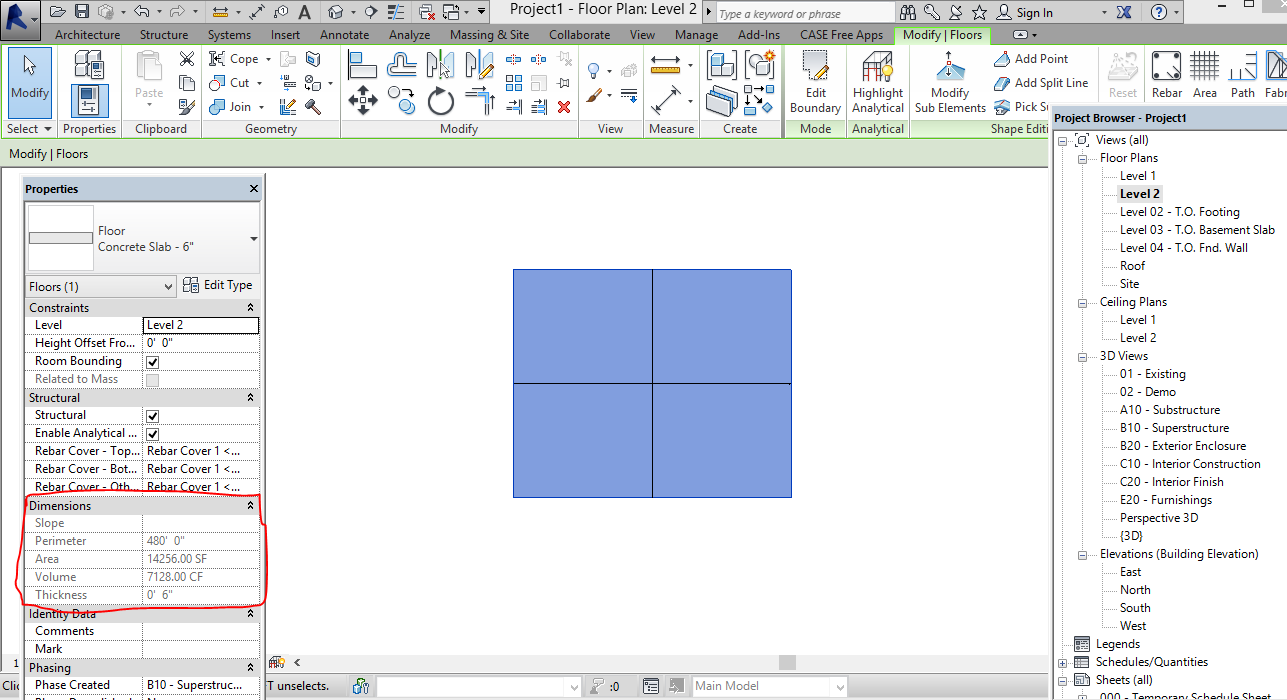

Hi,
While drawing foundation Slab I can see Dimensions at properties tab and same may be populated
to schedule as well (refer attachment).But, When I draw a floor slab it doesnt happen (refer attachment).
I want same to happen with floor slab. any help would be appreciated.

Thu, Sep 10, 2015 at 12:53:05 AM | Populating Dimensions
dgcad
dgcad Avatar
Joined: Thu, Mar 17, 2005
1231 Posts
3.5 Stars: 36 Votes
I never noticed that before and I'm not sure how useful those parameters are anyway. It's only of use if the slab is a perfect rectangle with 4 square corners. If the foundation slab perimeter has more than 4 sides or any angles those width and length parameters kind of go out the window or just become what would be the 'bounding box'.

Hi,
Thanks for observation, though I am seeking parmeters(LxB) for rectangular floor slab only, and they are required for sheduling purpose and very useful.
