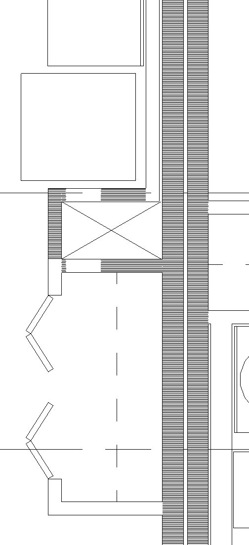

Hello,
I've encountered an odd problem with my 1 HR fire rated wall hatches. The hatch itself is set to "Align to Object" and is applied using a view filter. I am using Revit Architecture 2014.

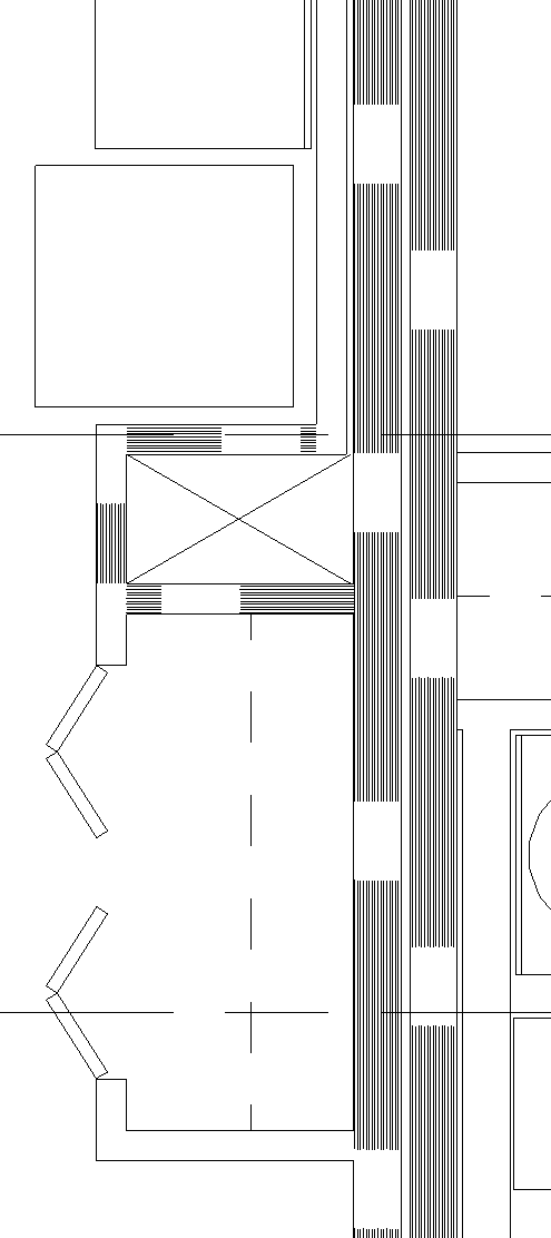

In the Coarse detail level, the hatch appears normally, and reads perfectly fine. (see below) Once I switch the view to a Medium view level, the hatch appears to have rotated 90 degrees, so that the vertical fire walls read as a solid black line. (see second attachment) while the horizontal ones are ok.
Very confused - I have not run into this before. Any help would be appreciated.

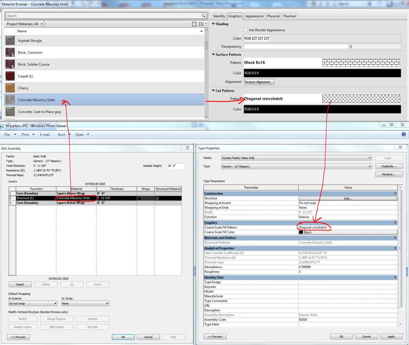

It looks like you have some discrepancy with your fill pattern. Make sure Coarse Scale Fill Pattern is the same as wall material cut pattern.
