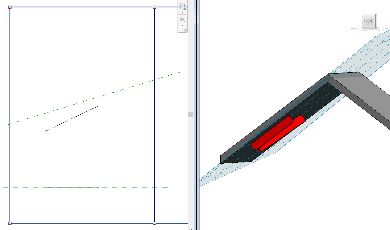

I have a roof supported by steelwork, I have set my work plane to the slope and drawn the beam in however how do I set out the beams in plan view? I have drawn 2 reference planes in plan, I can snap to the horizontal line but cannot snap to the angled line how can I do this?

In a plan view, if you set your workplane to the named sloping reference plane the beam should go in sloped. * On the Options bar make sure the 3D aspect is turned on.
