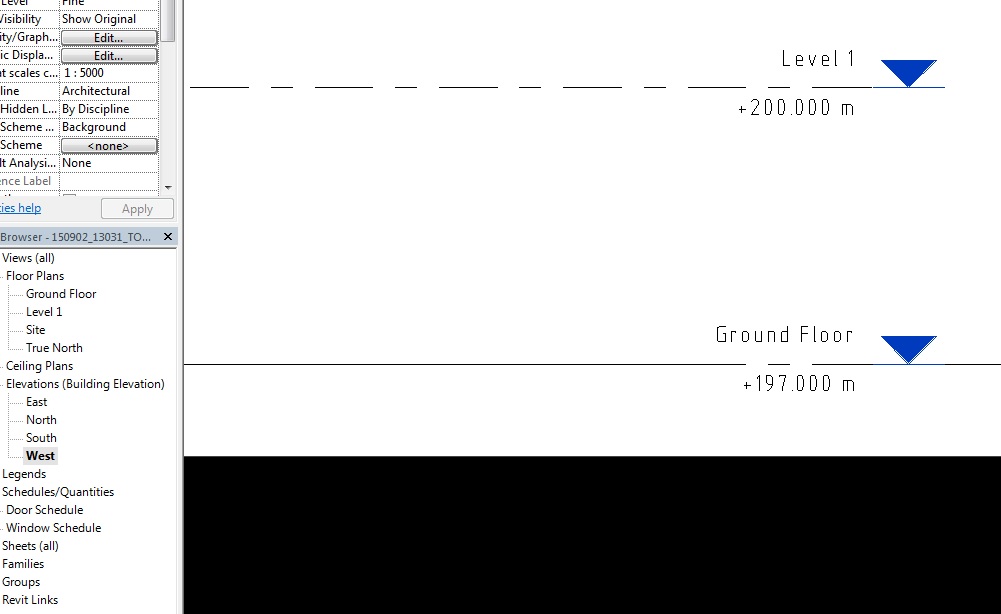

Hi All
Revit 2016 is the version.
Image attached.

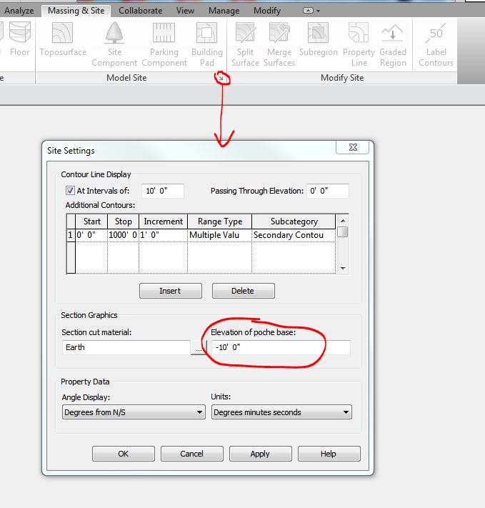

The situation: Got a job with a high elevation (approx. 196m as shown in the level markers). Each time I do this, I get a massive 'fill' from the top of the toposurface (196m in this instance) all the way back to 0.0m.
Really irritating. I'm guessing there is a relatively simple fix but haven't figured out the right google 'question/phrase to find the answer.

See picture, or use crop region.

Thanks for that ... however, it is not an poche issue.
Filled region is one '2D' way of working around it, but want the parametric solution if there is one.

iIf it's the topo surface then it should be the Poche depth. . . otherwise what exactly are we seeing in your image ?
Thu, Sep 3, 2015 at 7:42:44 AM | Black FIll Under elevation
Not just poche depth but what pattern for the poche.  Black solid fill?
