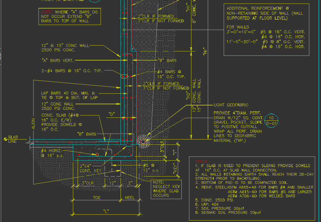

Hi everyone,
Any suggestions on how to create the taper in a foundation wall. Is it stacking 2 walls and then do a sweep? Or is this annotated in the sections?
Thanks for the help.
Mon, Aug 31, 2015 at 1:28:29 PM | Tapered Wall
It looks like two walls  (could be stacked) and a positive sweep will show it correctly. The sweep could be part of the upper wall definition.
