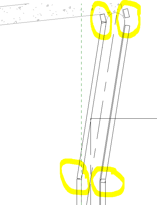

I have created generic model line based, based on other generic model. I would like to achieve so-called guide walls, with distance between them normalized by parameter (already done). However the problem is that when I am starting to draw loaded family in my model problems shown in enclosed picture happens. How to deal with them in such a way that it will be nice and easy to use them in future projects?
I enclose family file as well.
Regards.

What is a guide wall?  Why not a wall?
You will never get family elements to join like walls join.
