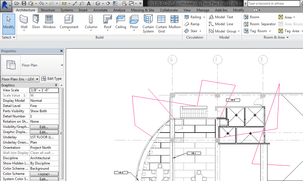

So I'm trying to draw room bounding lines in a design option to create my room schedule. When in the open,or on a floor that's not specified in finish, they appear fine.
However when there is a finish applied, or object above the plane, the lines disappear. Makes it impossible to trace them along a wall. Help? Please???

What was that image supposed to show us?   Come on - communicate - that is what this business is all about.
Room seperation lines are model elements.   Model elements above them will hide them.

Is there a way to make them visible over those elements then would be the question. If they are obscured by a wall element or floor element they are difficult to find.
Wed, Aug 26, 2015 at 12:31:58 PM | Room Boundaries
I sometimes change the thickness and color of room bounding lines so I can see them.  Wireframe view can help too.
