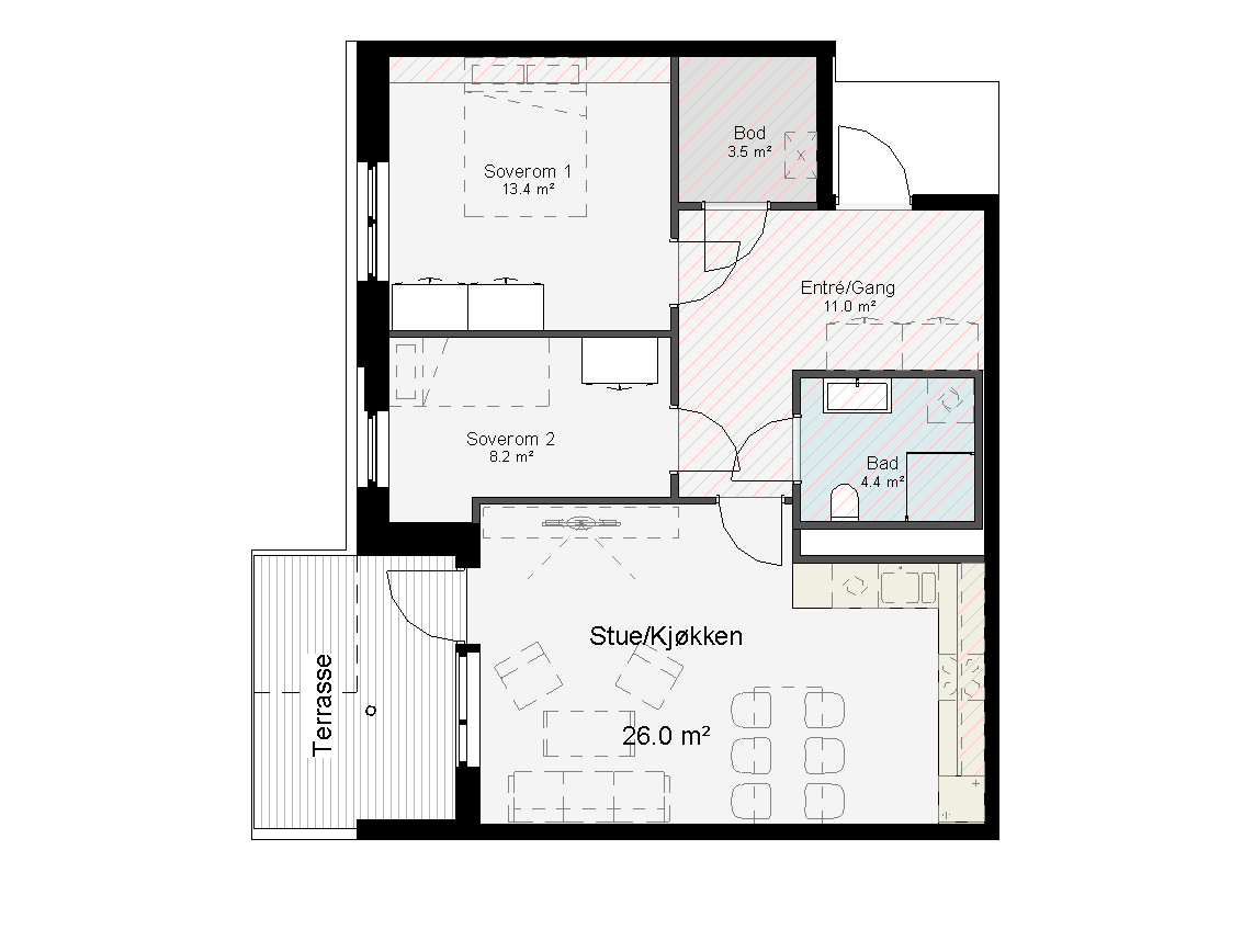

Hi,
I've having trouble with the graphics when printing to PDF.
In the example attached the ceiling has a hatch with diagonal red lines, and shows as a transparent hatch in the Revit view.
When printing to PDF the ceiling disappears behind the color of the Kitchen countertop, and the room color disappears behind the ceiling.
This only occurs when printing vector graphics. In Raster mode it turns out correct.
Is this a problem with the PDF printer or the Revit settings?
All inputs are appreciated!
Tue, Aug 11, 2015 at 9:40:16 AM | Problem with transparency/graphics when printing to PDF (Revit 2015)
Revit always switches to raster if shading is in the view to be printed so I don't understand why this difference exists unless it's somehow in your PDF driver.   Other users have seen problems with print order and solid fills in some PDF writers.
