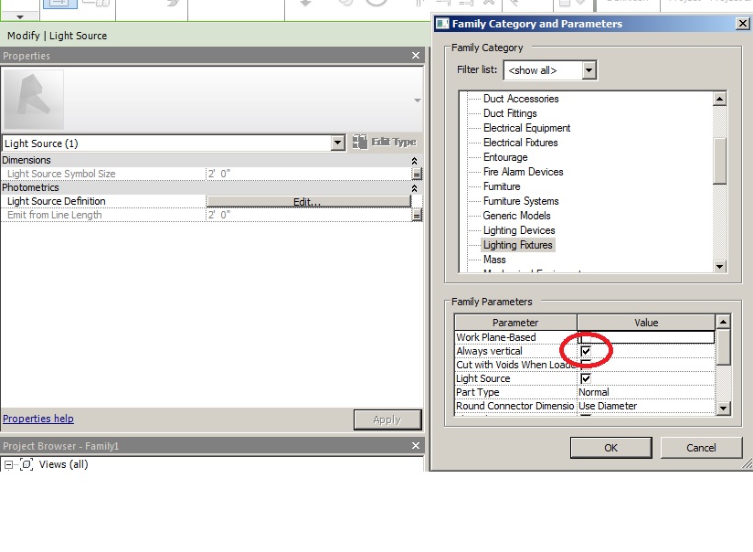

Using Revit 2015. Trying, desperately, to make a linear pendant that is a wall washer. I've tried everything I can think of...attempted to rotate the light source (using the rectangular option so it grows with the different size types), creating a solid extrusion to block the light on have the fixture... I didn't think any of these were good options to begin with and of course none of them worked.
Any other options I might be overlooking? I've made can wall washers with good success...i just can't tilt the direction of the light in the rectangular option and I think that's what I need to do. Tricks or tips??
Thanks!
Wed, Aug 5, 2015 at 9:02:19 AM | Linear Wall Washer Pendant
Your light angle settings are set in properties - see image.

Thanks, however I don't see that option for the light source I need. I'm using Rectangular / Hemi Spherical and I can't find any properties that will change the rotation. I need a long linear light (not wanting hot spots or scallops). Any other tricks that might work?
Thu, Aug 6, 2015 at 2:35:37 PM | Linear Wall Washer Pendant
Open the linear light source family, uncheck the 'always vertical' property and nest this in a generic family set as a lighting family.  Now add your controls to rotate the light source as needed.

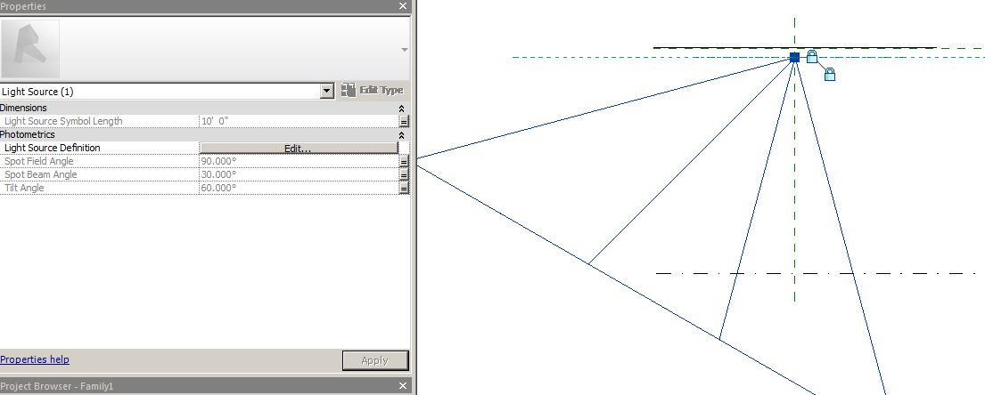

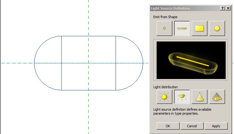

Mon, Aug 10, 2015 at 7:11:28 AM | Linear Wall Washer Pendant
You mean you are using a light source like the first image.
The always vertical is available on every family - second image.

Thanks, I think I got it to work via unchecking that box...it's at least closer to what the final intent is so I'm on my way - thanks. I'm still trying to figure out Revit lighting...it seems to make little sense when you get into rendering. But maybe that's just me.
