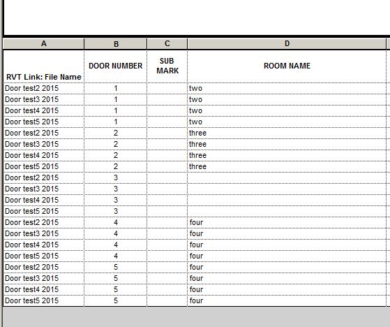

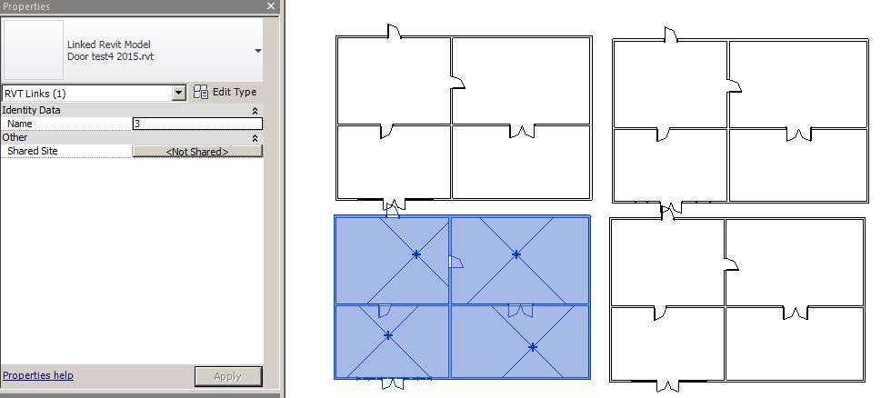

I don't have any problems.
Here is a model with 4  linked models (all same saved with different names) and the door schedule.
